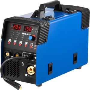

Any thoughts on this one?
jonesg
Mar 15, 2010
1,698
northern Maine/
Thats shipped from china, what if it shows up DOA.
Vevor imports whatever junk they can put their name on. Expect garbage and be pleseantly surprised if it isn't
N_Jay
Nov 1, 2016
1,215
Well, had a 12 month warranty, and can always buy with a credit card that has purchase protection.
I have bought one thing from them that seemed good for the price.
