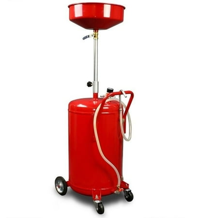

Trying to find a relatively low profile (36" or so tall) under lift oil drain pan WITH AIR evac. Anything over 40" minimum height will definitely not fit. Can find some that are poly containers that go that low but no evac on them.
So this style:

I don't know your welding skills, but you could cut an 11" section out of the top of that tank and re weld it.
You only use about 4 to 10 PSI to evacuate the tank so its not exactly a dangerous pressure vessel.
