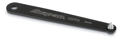

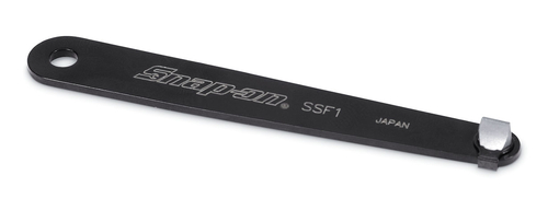

Here is a recent GJ thread about bit ratcheting screwdrivers with many low profile options: LINK.
Snap-on manufactures a 17 piece low profile bit set for $60.50 (with free shipping): LINK. If it is too much money, you can buy the bits (flat, phillips, hex, and torx) individually by clicking on the "Sets/Members" tab.

Are you talking about Snap-on model# 112RTSM which includes a ratchet resembling a T72? It is the low profile, pass-thru ratchet and socket set (5 to 13mm) with an included bit adapter. Here's a link to it on the Snap-on website: LINK.
The bit adapter was designed to be used with Snap-on's low profile bits: LINK.

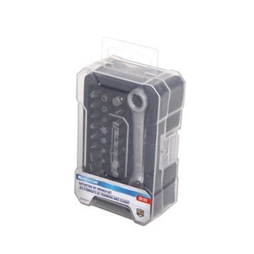

If you don't need one for every day use and/or its the wknd and need it now Lowes has a kobalt set for under 20$ that is fine tooth..

Funny that I see this thread today because yesterday while.I was at sears checking out the sales I ran into.the gear wrench set for 20 after some reward point things it was only 10. Been wanting one of these for awhile but could only find it for 30 bucks.

I used a 1/4 low profile ratchet from Snap-On with the bit holder. I used a average size P2 bit in it. The low profile bits would give it more clearance. For he money that Canadian set up might be a good deal if price is prohitive on he Snap-on.
