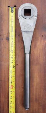

Shown here is a Lowell ratchet "No.1.O.S.B.B. WRENCH". Previously posted as a mystery ratchet, I've since uncovered the Lowell ID on the cover plate, and brought it into this Lowell thread. Cast lettering on the handle says "No.1.O.S.B.B. WRENCH". I don't know yet what "O.S.B.B." stands for, but "Bridge" could surely be one clue. I've included a 1936 Lowell ad (thanks Jabberwoki & four.cycle). Mentioned in this ad are "Bridge Builder's" wrenches which could explain the "B.B.", but what about the "O.S."?
The ratchet is 39" OAL, and the present insert is a 1" square female drive that's been weld-repaired but not finish-machined. I may call in a favor and have it broached back to size. The 3 position selector is a cool feature. Choosing the center position turns the ratchet into a fixed wrench (shown in one of the pics). Interesting that Lowell included this locked center position in only some of their ratchets.
Next I'll try to see what category/era this wrench fits into (see Lugz' consolidation info post #25). At this point, I haven't seen another Lowell that matches this one. It does have the same length & weight of the #1 Bridge Builders as shown in the ad.

Nice ratchet. I'm a big Lowell fan & collector but I've never seen a Lowell with graduated holes in the handle like that. They're still in business today & offer to make a custom tool for your job. I don't believe they offered that option back when your ratchet was made (just guessing). That's why I'm wandering if the holes are factory? They look clean & uniform, so I guess it's possible they're factory. I know I've seen the O.S.B.B. before. If I find something on it I'll let you know.
Here is an ad from 1920 stating that Lowell will do a special order tool for even a single customer. Also added a few other pics. They wouldn't forge the O.S.B.B. in the handle though for just one person. That would be on all the handles of the ones like yours. Maybe the holes were a custom order.
The other difference is Lowell Bridge Builder ratchet handles are flat with a hole at the end. Your handle at the end looks round with no hole on the end. Another clue while doing research.

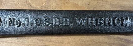

On the thread where you first posted this ratchet, back in July 2021, I opined here that "O.S.B.B." might stand for something like "Otis Smith Bridge Builders" and I posted an ad of a Bridge Builders wrench that looked very similar. Now I think it might literally stand for "Old Style Bridge Builders." Click here and read. It's a Lowell ratchets ad in the 1915 Sweets catalog. It explicitly identifies and shows four types of ratchets, called, by name, 1903 Pattern, Old Style Bridge Builders', Lag-Screw, and Steel Socket Bridge Wrench. I am 100% positive they branded the Old Style Bridge Builders' ratchet as "O.S.B.B."
I agree. The ad I posted above says "Old Style Bridge Builders." The only thing is PSCo1867's ratchet has a round handle with no hole at the bottom & a screw configuration on the face plate that doesn't match the standard Bridge Builders Wrench. But I definitely think the O.S.B.B. is solved.
Agreed. You had gotten me thinking Bridge-Builders and now I see that "Old Style Bridge Builders" is a real thing. Seems a bit wacky to cast that acronym, but I'm with you......I'll go with it until proven different! Your Lowell consolidation post is a major help. Still trying to nail down a patent.

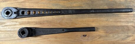

The photos show the OSBB on top and a #3 Red Socket Patent# 1798194 on the bottom. Pretty darn similar, right? The differences remain: full cover & 2 screws vs. half-cover & 1 screw, and 3 position selector vs. 2 position. And, the holes cast into the handle: have not seen this on another Lowell.
Like you said, the earliest ones had round handles with the exception of the 1864 flat handle version that matches D.M. Moore's patent pic. I think I could find hens teeth under a rainbow before I could find another one. Probably didn't make them long until they switched over to the round handle. They all have the 3 position selector.
Wow, those are some sweet pieces!
Ok, by "round handle early on", I meant "early on" strictly for a patent no. 1798194 (the ratchet that most resembles the no-patent-found OSBB wrench). I've seen plenty of flat-handled 1798194's (like your new acquisition monster Lowell 2 1/2), but not many round handled ones (like the Red Socket #3 that I posted beneath the OSBB). So, I'm talking 1930s era. Why? Because the round-handled 1798194 (shown in the 1936 ad) is the Lowell that most matches the OSBB (refer to my comparison pics). It's like the OSBB is almost a "Red Socket" era Lowell ratchet. I'm simply trying to fit this OSBB wrench into an established Lowell category, and failing.
Bottom Line, so far: The "No.1.O.S.B.B. WRENCH" Lowell ratchet is probably a "No. 1 Old Style Bridge Builders Wrench", possibly 1920s/1930s vintage, with ratchet mechanism and handle similar to an (early?) round-handle 1798194 patent Lowell ratchet. It is, however different enough that more research is needed.
Lugz, thanks! I didn't read your edited (updated) post until now. It is indeed the definitive answer to OSBB.
30,999
No worries.
It's one of the coolest markings I know of - the sheer and simple functional literalness, frankness and earnestness of the name to begin with (i.e., 'this is our ratchet for building bridges, but it's our old style, and we're just going to call it that'), and then they are so confident in the straightforwardness of their approach, that they abbreviate it on top of that! It reminds of Hibberd Spencer Bartlett's "Our Very Best" (often seen as "O.V.B.") marking, but without the superlative bravado.
I can see you agonizing over its features not quite making sense with everything else, but we have to put more credence on the name and model number matching the ads, I would take Lowell at their word for marking it that way, and not stress too much over it being a unique variant that is not an easy alignment in the sequence based on what we think we know about some of its other features. These are differences that would be important is if wasn't marked and we were trying to identify it empirically. They can't cast doubt on the marking, regardless of the ads we have.
