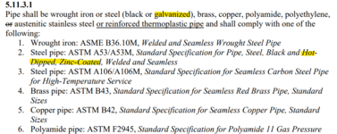

Galvanized is perfectly fine for propane, by code, as long as it meets A53/A53M specs. NG is the one that attacks galvanized pipe. NFPA 58
Flex line is usually provided by the generator manufacture. It looks small because they oversized the iron pipe.
The paint looks like cold galvanizing to me.
Sure. But the pipe looks odd to me, almost like it's RMC...

It looks like its electrogalvanized. Without looking at the stampings the pic really doesn't confirm if its RMC or A53 to me
Really? All the installs around here are hard piped. It looks small to me, but that's based on the size I had to use on my on demand water heater to hit the BTU/hr rate.
Every generac and kohler I have installed recently have had a flexible fuel line with the generator and require 5' of hard line beyond that according to the manufactures instructions. If they are not installing them they are not following the manufactures instructions.
Sure..but why randomly add black pipe fittings into a galvanized run?
I don't know, technically not a code violation. One county here requires all gas pipe outdoors to be painted grey. Why gray we have not been able to get out of them. But yellow, the standard color is not acceptable to them and they will fail it if not grey.
The installer really should have painted it all one color for craftsmanship reasons alone.
