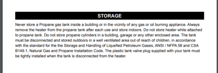

Then explain the tank mounted heater instructions specifically mentioning indoor use.
Answer: NFPA (National Fire Protection Association) regulations make it unlawful to take any tank larger than a 1-lb tank inside a residence. The regulations were written to protect you from potential problems such as a leaking propane tank, fire, and possible explosions.
You need to re-read that nfpa section.
Storage and usage are two different things.

Let's not confuse bulk propane stationary tanks and the smaller portable propane tanks (100 lb and under). And the difference of inside a residence (living area) and other. After all, you drive past or work in places with many propane tanks inside used for fork trucks and other. I am sure they aren't all not following some type of codes. As a matter of fact, look up the "no smoking" distance for propane cylinder storage.
Propane storage instructions link
another link
another propane storage suggestion link

You can use the heater (with attached tank) inside.
Usage and storage are mutually exclusive.
So, using in a well ventilated garage, sure. there is a lot of grey areas to that. Not in a house or place of residents. you can use for commercial or new builds
Like i said, be safe.
There are so many times i went out to determine why a propane tank exploded. Most times was leaks from the tank at valve and ignited. other times when the tank was overfilled and relief valve went off.
You should watch how the 20lb tanks are made, its crazy that's all that holds back the pressure
