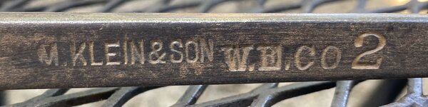

I picked up this lineman splicing clamp Sunday. I tried fruitlessly to find a youtube video demonstrating how it was used. I assume it just holds two wires parallel while you twist the ends around, but IDK.
The other thing that tipped me toward buying it was that it doesn’t say M.Klein & Sons, but just M.Klein & Son. AA shows an 1898 advertisement with the same name, but erroneously captions it M.Kein & Sons. I don’t see a mention in the company history on AA nor on the Klein site that gives a date when a second son joined the firm.
I suppose “W.E.Co” is Western Electric.

It could hold a lead slug which crips down on two wires. This was not something they knew anything about at the phone company, or at least no one told me about it!
30,500
...it doesn’t say M.Klein & Sons, but just M.Klein & Son.
Nice. The "Pre-Plural" era. I'm assuming it's not dated, either, predating dating. :) And we now have a new "Oldest Pliers on the Thread", edging out @Bryan Burns "1911", post #110.
According to this biographical reference, the first son, John M. Klein, was born in 1856, joined the company in 1883, and the name was changed to M. Klein & Son at that time. It provides a paragraph on the second son, Joseph A. Klein, born in 1869, and mentions the final change to the company name when he joined his father and brother as a toolmaker, but does not provide a date. The earliest I have been able to box it in based on ads is this reference to & Sons, dated 1904.

It is done with a tinned dipped crimp link for an inline joint its primitive but depending where you are in the world a tool that could still be used . It’s for stranded cables not single core.
Thank you. Could you call that a **** splice? Or am I picturing it wrong?

The link is crimped on both sides of the indentation cable is inserted either side before insulation is applied to the link only stranded cable can be used . Here is the current tool that’s used throughout the electrical industry. But the Klein tool you have posted is still available in places like India based on the Klein design.
