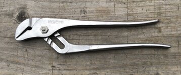

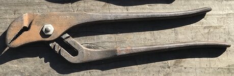

Found these at an Estate Sale this AM. Never seen the logo in this orientation. Brief research makes me think these are quite early? Only markings (besides owners initials) are a 9 or 6, and a V that may or may not be factory.
