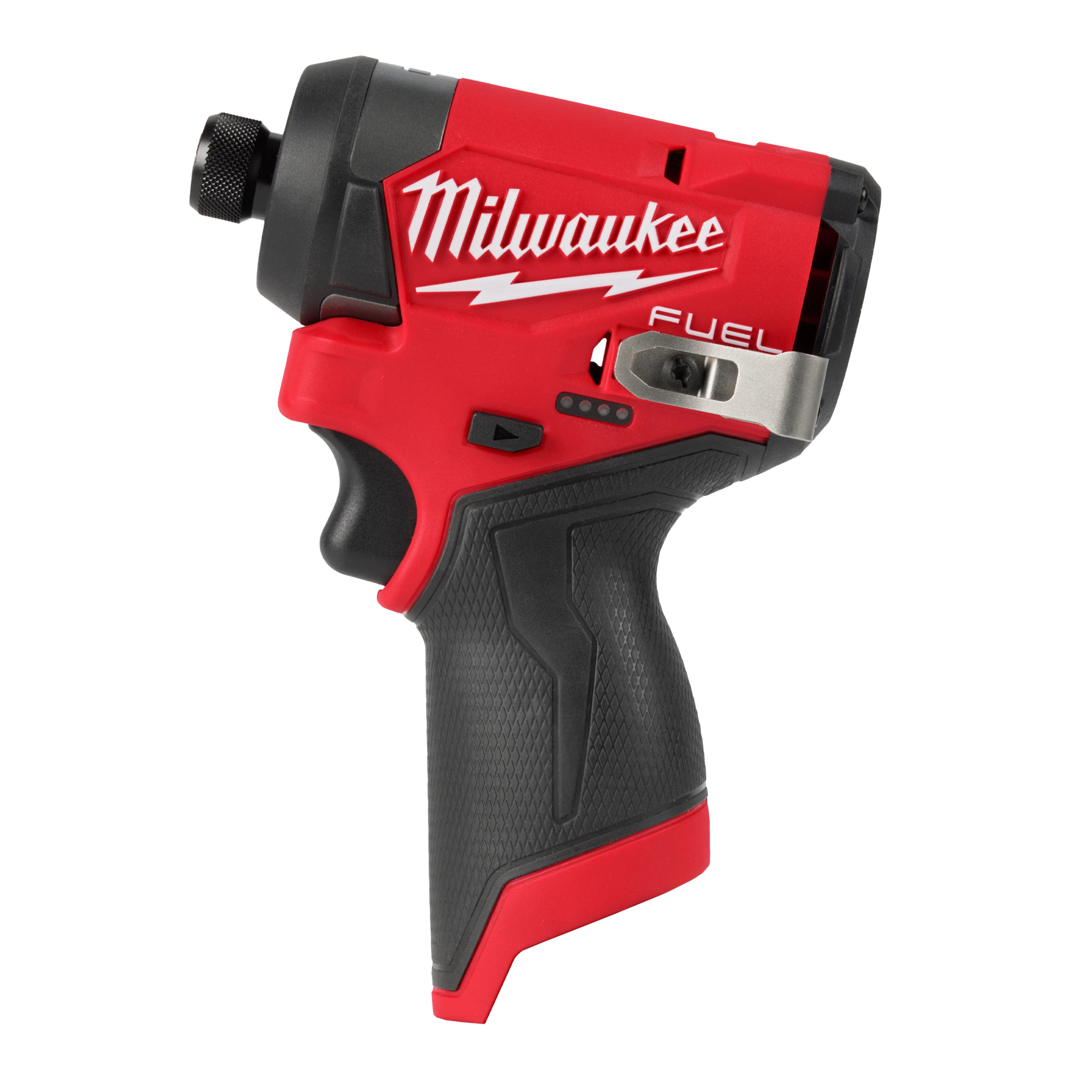

FYI, The M12 Subcompacts 3450-20 & 3401-20 (nor the M18 Subcompacts) are not FUEL models. They are just basic brushless models with no added luxury features. In the past Fuel meant brushless but that's no longer the case now.
I have the M12 Subcompacts, even though I am not a fan of M12 ergonomics I am happy with them..... for their small size which is the main reason I bought them. They are not my primary use tools & I would not be happy with them if it was all I had. They are a supplement to my M18 Fuels which I uses primarily.
The 3450-20 impact driver has no bells & whistles, no modes & no quick collet. Doesn't have that much power compared to M12 Fuel but again the small size is what I got it for. For my needs the power vs the size is acceptable. I really wish it had a quick collet though.
My only dislike about he 3401-20 drill is that it's too slow. I really wish it was faster. The 3/8' capacity doesn't bother me.
I work in automotive related, not repairs. No idea how they would suit your needs.

Woops, just realized those models are Fuel models.... they are not considered Subcompacts. A new line of M12 Subcompacts came out this year & are what I'm talking about in my previous post.
I don't own any but I have used M12 Fuels. They're decent powerful tools for their size. There were occasions where they couldn't do what M18 Fuels did but for most tasks they are sufficient.

To avoid any confusion, again Fuels & Subcompacts are completely different models. Fuel are top of the line.
These are the Subcompacts (non Fuel).

IDK @darkzero the Milwaukee product page as well as the Home depot description calls them subcompacts.
Right you are & I can't argue that. But I believe that's from before when a number of brands started offering what they called subcompact sized tools. Ridgid was one of the first. Dewalt with their Atomics. Used as a description & not actual model name.
This was long before MW came out with the M18 Subcompact models & this year the M12 Subcompacts, and just recently the M12 Subcompact Impact Wrench.
Now that there are actual Subcompact models, search M12 Subcompact & see what pops up now.
But no matter M12 Fuels should perform well for you. I just can't stand M12 grip size so I avoid them whenever possible.
