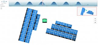

Hard to say, but 'clipping' was my first thought also. Are you able to look at the output of each individual panel as the day progresses? My Solar Edge inverter has a 'playback' feature and charts the data every 15 minutes. It is useful to see if the panels are performing properly. For example, I have one panel next to the water heater roof vent that gets some shade from it in the afternoon. In this pic, you can see the lower right panel is underperforming because of it.

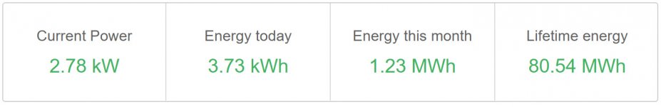

In another month, our system will have been installed for 4 years, and so far it has produced 80.54 MWh. 20,000 kWh a year is worth about $5k using $.25 per kWh so 2 more years the system will have paid for itself. I thought San Diego electrical rates were even more expensive?

It would be my first guess also, just need to see more data over time to know. I do have single panel monitoring as well, here is the highest output on that same day:
The best panel is 305w which is over the inverter 300w rating so it’s reasonable to think it’s clipping. Really only one or two panels which beat 300w and for only a few minutes, not extensively for hours. Could be that one or two of the inverters maxed out, but others didn’t which is why it’s flat without ever reaching the theoretical max 4500w output.
OH THEY ARE (https://www.sdge.com/whenmatters#plans), but only at certain times and seasons. Time of use rates in the summer vary from $0.20 to $0.52 per kWh. The winter rates are much more reasonable, max $0.27 I think. Generating as much solar power during that on peak, 4pm-9pm, time slot was a high priority. My system did a pretty good job between 4pm-7:30pm with excess generation, so hopefully when we do run the AC those few hot weeks in San Diego, I still wont see a bill.
Otherwise, the repurchase rate for excess generation after the annual true up period is a joke. I think its $0.04 per kWh. Basically nothing.
