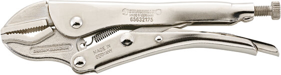

Monte
Dec 23, 2008
12,720
Germany
Gedore make (some ?) locking pliers on their own (in Austria). It seems some are bought elsewhere. Gedore model 136 K-105 looks spanish for example (Grip-On 181). Model 137P looks like a "Wezag" model (coarse knurling, release lever, bright finish). Wezag stopped production of locking pliers a while ago though. (Maybe the photo on the Gedore site is old). AFAIK only Bollmann produces here anymore.
From the Wezag site:
I think this is another Wezag product:
Stahlwille 65632175 . I don´t think you´ll receive this design though......
but instead you´ll get this:
Stahlwille 65632175 ...Bollmann style....
