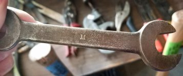

Well... this is certainly timely... I was working on "Manzel" about a week ago, but back-burnered it .... there had been a question regarding the "M" they used as their "LOGO" on their wrenches, which got confused with the logo used by Moore Drop Forge.
Manzel / Manzel Bros., 309-335 Babcock St., Buffalo, NY / est. 1896 inc. 1906 became Manzel Division of Frontier Indstries / patent 791636 Jun 6 1905 & 820979 May 22 1906 & 828326 Aug 14 1906 & 829166 Aug 21 1906 & 832265 Oct 2 1906 & & May 4 1909 & 920769 May 4 1909 & 921327 Aug 17 1909 & 1003189 Sep 12 1911 Charles W. Manzel & 1014403 Jan 9 1912 Adolf W. Manzel & 1069450 Aug 5 1913 & D45943 Jun 16 1914 Charles W. Manzel & Adolph W. Manzel & 1201324 Oct 17 1916 (* some existing specimens are erroneously stamped with date of Oct 18 1916 *) & 1213522 Jan 23 1917 & D51729 Feb 5 1918 & D57987 May 24 1921 & 1521822 Jan 06 1925 & 1620824 Mar 15 1927 & 1637869 Aug 02 1927 & 1648140 & 1761891 Jun 03 1930 & 2012724 Aug 27 1935 & 2515524 Jul 18 1950 Charles W. Manzel / http://vintagemachinery.org/mfgindex/detail.aspx?id=5099&tab=0 / http://alloy-artifacts.org/other-makers-p4.html#manzel / see also Tomahawk Mfg. Co., Cleveland, OH /
It would appear that Manzel used both a serifed ("typewriter") font and a plain block sans-serif font on their wrenches. The Moore logo was an "M" inside a circle.
