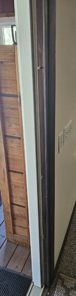

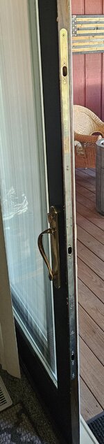

House built in 1978, pretty sure the Marvin Windows sliding glass patio door is original.
I would like to (try to) replace the outdated bronze/brass handle and lock assembly
Any idea if this is possible?
The locking mechanism secures to the frame via 3 evenly spaced posts. Very solid and very secure compared to modern day doors IMHO
I attached pics for reference

I need keyed, with TWO top screws and ONE bottom
I can't find this style anywhere online
Approx 1-3/4" wide and 12-3/8" long
I would like to change to a white color or brushed nickel

I need keyed, with TWO top screws and OME bottom
I bet you don't, have you taken this apart and looked at it?
I bet either the outdoor/indoor half are matched, so the new set (with 1 screw) would be as well. Or it screws into the wood, and again as long as the hole isn't dead center it will be fine.

Marvin parts only come from Marvin dealers. If you have your original door order, a dealer should be able to get you new hardware.
However... I just need a small piece of window trim for my own windows but can't get the time of day from any Marvin dealer because I'm not buying any new product from them. :( Not sure I will ever buy Marvin again.
wssix99
Mar 2, 2011
5,162
Chicago, IL
Then you'll have more effort to get things matched up. I would take as many detailed pictures as you can with measurements to give to a dealer. (They may need to pass that info on to a rep to have them do the research to find your parts.)
Any stickers with numbers on the top or bottom of the door with serial numbers might help. (You may need an inspection mirror to look for these things.)
I looked everywhere, no numbers anywhere to be found

From Marvin:
"The lock for your door is no longer available, sorry
We have a retro fit handle option for product that was manufactured from 1991-2002. Please see the PDF service attachment. You might want to reach out to an aftermarket website called allaboutdoors.com "
