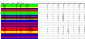

One of the time consuming challenges you could imagine was determining the proper shelf dimensions for each set. Since I didn't have all the sockets from each set I had to interpolate what the cruical dimensions of the set would be mainly the diameters of each socket. Since I have a pretty solid catalog of what sockets are in what sets I was able to find a correlation between socket size and OD (outside diameter) of each socket. Different series had different correlations due to the required wall thickness for the application. Using Excel I was able to find these correlated values then calculate the shelf crucial dimensions.
After calculating the size shelfs needed for each set I then built a table of data for each dimension that referenced the generic design. It turns out I need 49 shelves.

Next step in the process was determining board space so taking measurements for each socket shelf. Taking these measurements I generated a space allotments in a few crude CAD program called draw.io (great free web based program for flow diagrams, schematics etc.). Playing around with some ideas I think I am going to organized primary on date and secondary on drive size. Color coding each socket shelf in excel and tagging it with an indices help with the spatial layout.
Having the outer bounds be the dimensions by a sheet of plywood helped.
Here are the results:
Overview:
Green is pre 1930 (alpha character part numbers)
Blue is LA series (1930s-1940s)
Red is 1940s
Yellow is mainly WF and other contract productions
Zoomed in view of the layout:
While this is not the final layout but it appears to will be about 4' W X 6' H.
I plan to test the concepts of the shelves in and design something for the socket retention so they will not slide off the shelf easily.
