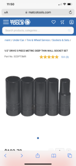

I have an opportunity to buy this set for around the same price as the various import options. Do these sockets use Matco’s Opti-Torque pro technology?
I am not too familiar with Matco’s line-up, but the bag shows USA.
