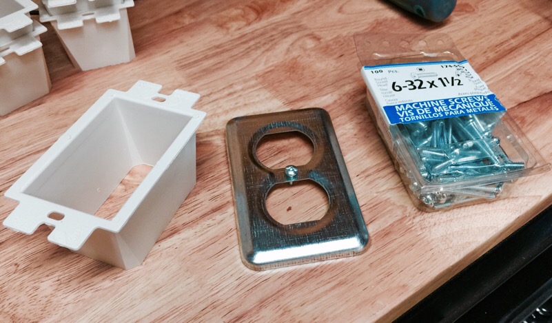

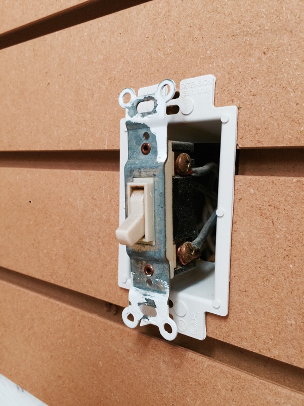

Johnnie, it's just MDF slat wall. My walls (plywood from previous owner) were in rough shape for paint, and I was liking the versatility of slat wall. HD sells it. This stuff was from Windsor Plywood locally. Once you do the slatwall, you can go crazy with organization. Keep in mind that you'll need to extend your electrical boxes. I've just clear coated the panels with water based Varathane x 2 coats.

Electrical box extensions!!! I've never seen such a thing. Man I could have used those before....
I was considering removing the drywall and replacing with this stuff, but I'm not sure how the fire code folks would feel about it. Sounds like you had plywood before though, so maybe I'm overthinking this.

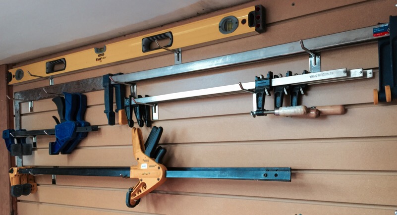

JohnnieMo
Nov 25, 2014
1,175
Calgary, Alberta
The slats in those wall boards must be quite strong to hang the MaxJax arms on there. That was my concern about the MDF.... whether or not it could hold a load.
D
Denwood
Sep 22, 2014
4,236
Thunder Bay, Ontario, Canada
Von, thanks :)
Johnnie, MDF slatwall is good for around 30lbs, 1 ft out from the slatwall, at least acording to this test:
The shelf brackets I'm using for the lift pads are for 8" shelves and have a larger flange to engage the slat wall, so likely good for more weight yet. The Youtube test above used a pressure sensor 12" out from the wall (so a fair bit of leverage)..and the MaxJax lift arms only extend 4" from the wall. If they did the test at 4" away, I'd guess about 90lbs would be required before breakout. I have some scraps so perhaps I'll do a test to failure and see how it does :)
