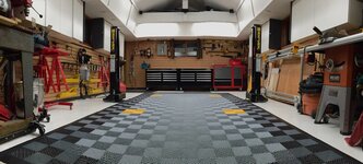

The Maxjax lift in the shop has been working fine since purchase, aside from an unequal lift issue. My custom install added an extension to the hydraulic hoses (one hydraulic hose runs under the floor in conduit to the far side post), and my shop is 1” out of level, so this did not help. Switching lines around and replacing the flow balancer did zero to help. Adding a flow control valve on the “faster side” did the trick and now the lift is dead even to the top.
As a plus, the shuddering issue when the lift was out of level is gone as well. This 3/8 NPT flow control valve along with a 3/8 NPT male to male ****** did the trick. It’s attached to the stock flow divider that is supposed to keep hydraulic flow exactly equal to the two lift cyclinders. Despite the flow divider, the flow limiter seems to be required to tune things up so the lift is even and both sides reach the max height at the same time.
The KC-03 "3/8 Hydraulic Tube Type One-way Throttle Valve" can be found on Amazon…specs below. it limits flow in one direction and does not seem to affect lowering at all. I had to dial in a fair bit of restriction (clockwise rotation) to get the lift to work more or less perfectly in sync.
I have the power unit wall mounted on the left and run an extended hydraulic hose to the right side post via conduit buried in the concrete.
