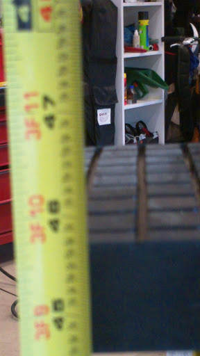

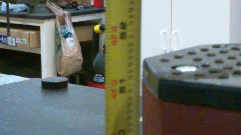

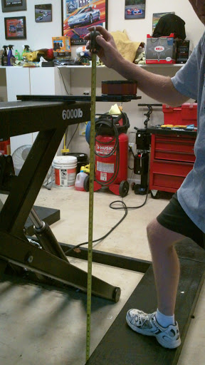

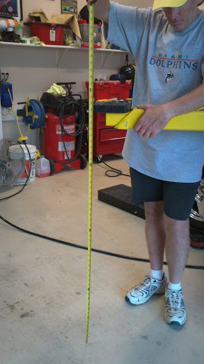

Lift Height and Positions
This section will be important to some depending on the type of work you'll plan on doing. The general idea for me was to get the car up to comfortable working positions to save on my back and try to make jobs go faster.
The mid-rise has the higher lift of these two lifts. No the working height of the lift and access will depend on the clearance of the vehicle and the lift pads used. But trying to keep all things equal, the mid-rise will lift the bar arm to a height of about 49 3/4" while the MaxJax lifts to about 44 1/2".
Sorry for the poor pictures but here is are the views, mid-rise followed by MaxJax.
For me the place where this becomes most important is how easily I can fit under the vehicle on a rolling seat. I've used the mid-rise more thus far so can't comment for sure on the MaxJax, but given I'm about 6' 1" and I use a telescopic rolling shop seat, I can drop it to the lowest setting and I was able to work fairly comfortable under my Dodge Dakota pickup. I did have to duck my head, but I wouldn't say it is uncomfortable. I'm curious about this on the MaxJax and will be doing a job on the Z06 soon that requires this type work so I'll know more then, but I would only assume that it will be tighter given the difference of about 4-5" of height
As for lift positions both lifts are to use the hydraulics to lift the vehicle, but then to place the load onto the safety lock positions. The Atlas has 7 locking positions in a variety of heights, I really like this as I can get the lift to a good working height depending on the job and have it locked in place. The MaxJax has two safety positions, one at full lift height and the other mid way.
Conclusion: The mid-rise with slightly more height and more positions gets the edge in this area.

Help me out here~ when I measure from where the lift pads would go to lift my mustang, I get about 45"(very rough measurement, I'll measure more accurately tomorrow), that's from the frame(like where a jackstand may be placed) to the top of the roof. Surely you can't go by the entire height of the car right? so if the lift maximum height is 45", that'd be only 90"s and my ceiling is right at 8':dunno:?
Well - we have a 70 Mustang and a 67 Falcon. The Mustang would just barely make 8', maybe. I'd have to measure. The Falcon - no. With a MaxJax, it'd need 9'+. I'll bet you have the same issue with the 57. Tall car.
D
Dolfan
May 21, 2010
465
Greater Atlanta
That sounds about right to me based on what you've written here. Let's break this down, if you look at this picture it shows the height of the regular lift pad in the full lift position, as 46"
But, you can only add that to your car height if you were to start with the frame right on the lift pads where they sit in the down position, which is about 4". But if you can use the "truck pads, and meet the frame within maybe an inch, I would figure the formula would be something like this
Total lift = (lift final pad height-distance of pad to frame) + height of vehicle from frame :eyecrazy:
