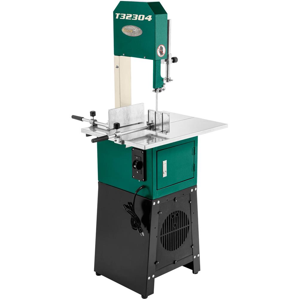

Try looking up the specs on a meat saw & see how they compare, probably doesn't have the power or accuracy as one made for resawing, I do like the large table. Here's one I saw at grizzly, probably better off with one meant for wood.
Oh, Ok, sot so good for resawing.
Maybe OK though, for roughing out bowl blanks. I like the height under the top guide.

The meat band saw I see in the meat market are really sturdy.. not sure if the same is on the one you are looking at... cuts through hard beef bones like butter. and its stainless too.
I'm not trying to dissuade the op but you need a good band saw for resawing, especially if its seasoned hard wood, good roller bearing guides,I don't see the meat ones as really being precision machines.
LOL I have never have a precision cut beef bone to the .001" but they are pretty uniform in cuts. LOL.. I don't have any real experience on that department other than what I see on the meat market, they cut it in front of you... when they cut the bones for me, give me the creeps...

Meat saws are typically standard issue with stainless tables in lieu of carbon, nothing special unless the butcher specified

The big difference with meat bandsaws is they are basically flip-flopped from regular saws. This is due to when you cut meat you are usually standing to the side of the blade. With most people being right handed the table orientation makes more sense this way. You hold the product with your dominant right hand and catch the cuts with your left. If you were standing in front of a wood saw in the typical way with the side cover to the left of you the blade would be backwards on a meat saw. On a wood saw your dominant right hand is on the outside of the blade but using a meat saw it would be to the inside.
I don't know if I'm explaining this in a way that makes sense but I do have 20 years of daily experience on a meat bandsaw working in retail grocery.
