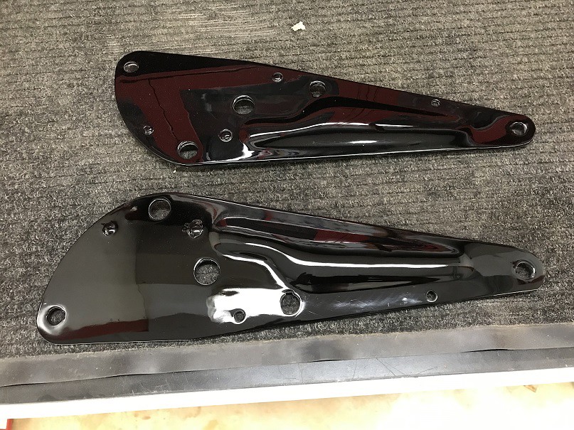

I painted the 2 body sides black last week after grinding all the rusted pits out of the panels. Today I managed to get them color sanded
2019-04-16 16.01.41 by don long, on Flickr
Then buffed up to a high shine
2019-04-16 16.12.42 by don long, on Flickr
2019-04-16 16.13.45 by don long, on Flickr
I'll be putting this jack together in a couple of days.
I'm hoping that the polished steel pieces will pop against the black and red colors
