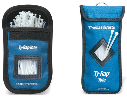

I'm not sure what Superbec means, but my guess is one of these:
news_ty_rap_tote
