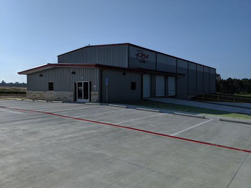

Readhead knows his stuff. We have a bunch of metal building contractors in Texas to choose from. I have used three over the years. I always went with local recommendations, got bids, interviewed them, etc. This last guy I used was excellent (link below). He won't be any help in California, but you get the idea. There are metal buildings and there are light weight metal structures. Around here we get tornadoes, big hail, trees come down, etc. I want mine to still be there.
