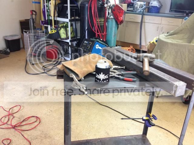

Tools Used:
4.5" Angle Grinder
4.5" cut off wheels
4.5" 60grit flap disc
Center Punch
32oz Ball Peen
Porter Cable 18v Drill
Wire wheel
#7 Carbide Drill
7/16 Drill
Countersink
Miller 211 Mig Welder
C25 shielding gas
24" metal square
2 Magnetic Welding Clamps
3 Hockey Pucks
Sharpie
5" Bench Vise

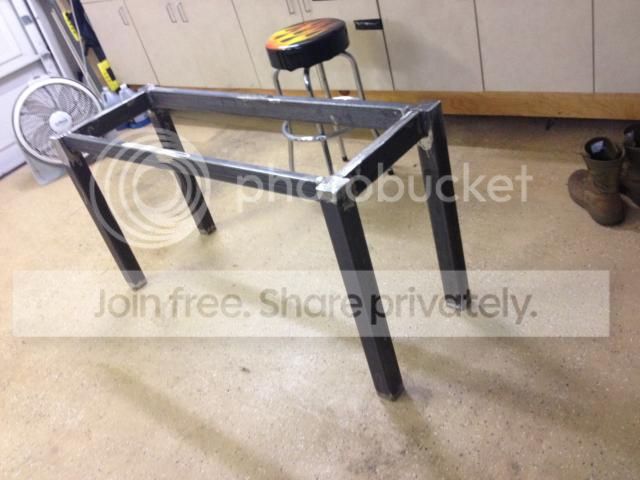

So to start I cut all of my materials up and tacked together the basic frame
Then I made my design and drilled the holes in the rails of the frame
Bend and cut my design pieces
One side together. Took some fighting to get all of the pieces in between the rails. But I think I figured out a good groove for the next 3 sides.
THis is how the bent pieces sit between the rails currently. The ones that have split pieces I had to tack together to keep them in place. The ones that are straight between the rails are just floating in there for now.
I have decided to weld all of the pices in place. Orginally I wanted to TIG weld them to make it cleaner, but after experimenting with the MIG welder I have it doesnt look bad.

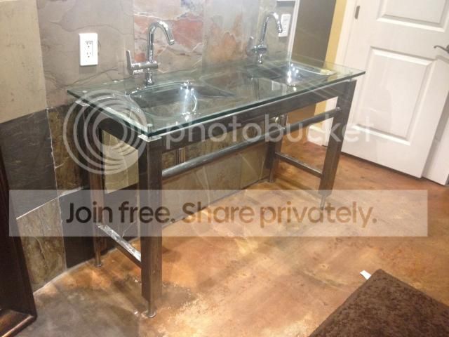

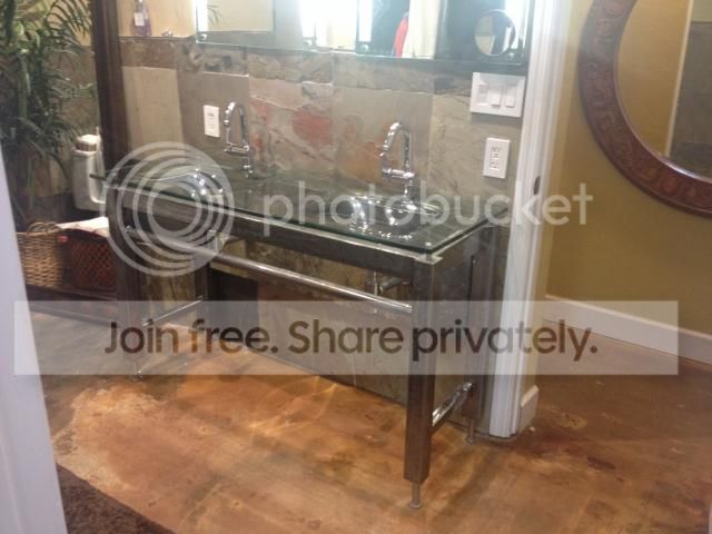

What did you coat the table with? I respect your creativity, that thing came out great. I am inspired so thanks.
I built a simple sink base last year of similar construction. I ground it to bare rough steel, wiped it down with Ospho, and shot it with a matte clear powder coat. It kept the industrial look without being too flashy. I added a glass top and some legs / risers from Ikea. The clear powder coat has worked out very well.

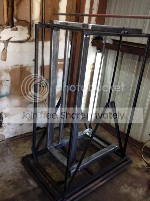

Got started on my top today. After talking with the GF i decided to go with C with the overlapping lift top.
Got all of my pieces cut up. Again had to do it with the 4.5" angle grinder and a cutoff wheel
Got everything tacked together and kind of mocked it up on top with some magnetic blocks. Good idea of how its goign to sit when done.
Ended up getting almost another 8 inches out of it. I am happy with the length now.
Laid out what the top is going to look like. Still need to order some steel to make the top pattern.
More to come after i get some more materials.
I havent coated it yet, planning on either getting it clear coated to clear powder coated.
That sink looks awsome, is the actual sink clear glass as well ?
bombtech
Oct 25, 2014
23
South Florida
Yes, the whole chunk is 1" tempered glass. It looks like someone just magically pushed a bowl down in the glass twice. It was too unique to not use. I bought it from a importer who was going out of business years ago, the original base was some fake mahogany frame that didn't belong with such a cool countertop.

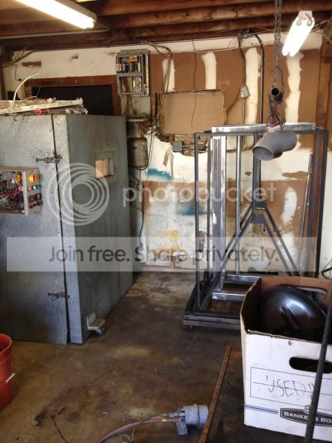

The powder coat was really an interesting process, I actually did it at a friend's MC shop. His oven is big enough for bike frames and I had just about 1 inch clearance above the table while It was baking. You have unlimited color options and finishes in matte or gloss tints now with powder . I recommend it if you have the option available just for the sake of durability. Mine is in a humid environment so I had no choice, but now that I see the finished durable coating I will use it on everything.
I have been looking for a chunk of reclaimed wood to make the shelf from. It will span across the lower supports. I wanted to maintain the Earthy tones in the room. I live in South Florida. Nothing here is old but the drivers. Reclaimed wood isn't exactly laying around for guys like me to find in barns. Next road trip North will hopefully lead to something.
Where are you getting the wood from on yours?
