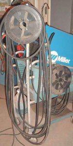

Mine was made from one inch square tubing and bed rails, etc, and other junk that was on hand. Most any material will work, not much stress on that type of construction.
