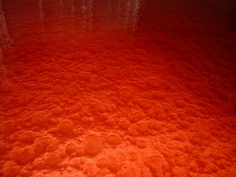

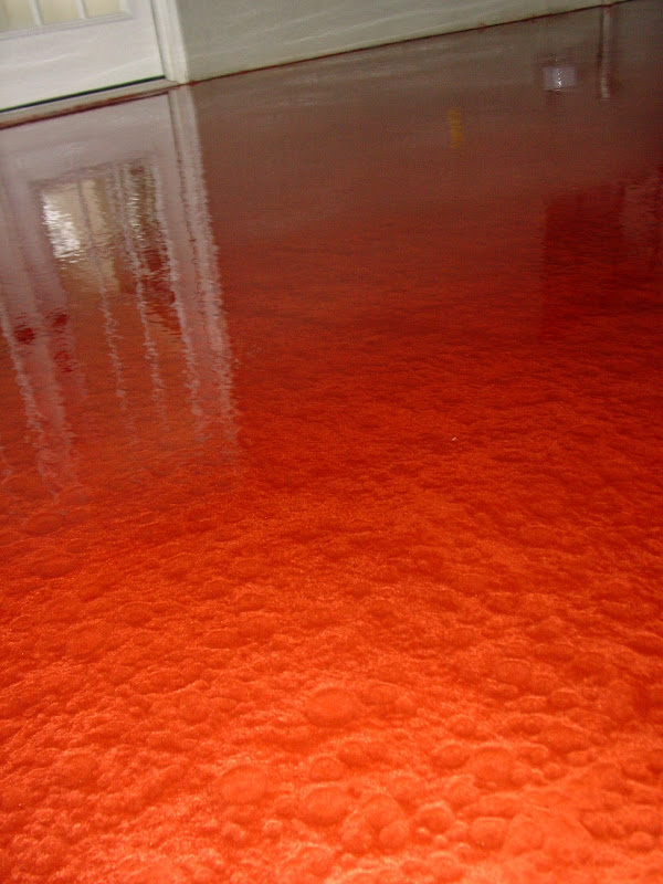

I did this recently on the floor in a party room / bar in a lake house. I'm really happy with the texture and appearance!

Nice! Looks like Autumn Blaze color, am I right? Did you use mineral spirits or denatured alcohol?

the pic looks like it was taken as soon as it was sprayed. Do you have pics of it after it healed itself a bit?

Actually, the pics were taken the day after the installation, just before I put the urethane on.
I timed it when I was doing the application and waited until a full hour after I did the mix to put the MEK texturing on. I think that helped it 'stick'.
I think I'll try something a little less volatile and noxious than MEK next time.
