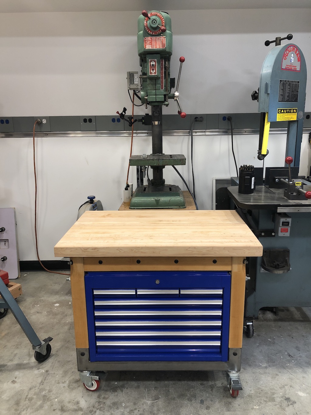

Picked up this 60s-era PowerMatic 1150 a few months ago.

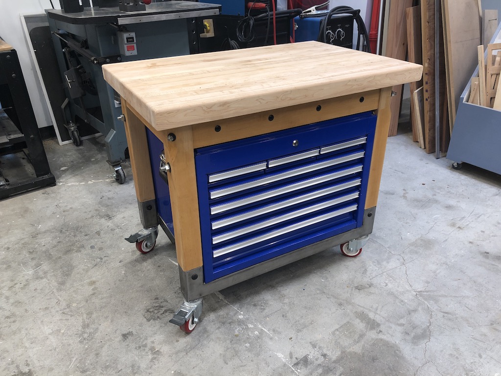

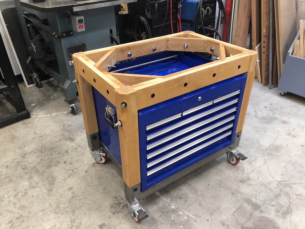

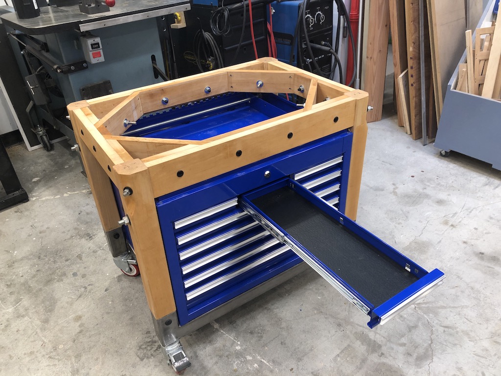

At first I was a bit disappointed that it wasn't a floor model but then I realized that if I find a solid Lista or Vidmar cabinet that I would be able to use that space to store all the drills, bits and tooling for both the mill and lathe. So I suppose that it won't be a completely free upgrade but nonetheless it's pretty awesome.
This is exactly what drove my choice to get a bench model. I despise wasted space, and a floor drill press is the poster child. I've been building this frankenbench (from an old butcher block kitchen island) for the last several months. Metal base to hold stem casters, HF top box, and wooden frame reinforced to kingdom come. The legs are bolted to the tool chest, which makes it even more rigid.

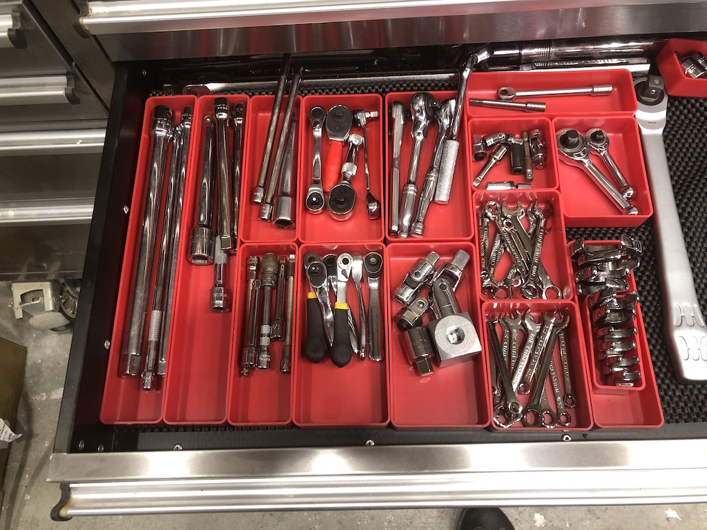

The thing about this particular tool chest is that most of the drawers are shallow, perfect for 1" Schaller cups to organize the endless amounts of bits and bobs that are essential around a drill press. The drawers are deep (front to back) as well.
I'm almost done with the build, today as it happens -- just have to fasten the top on and throw some poly on it. Then I get to try to move the beast of a drill press onto it.
The thing about this particular tool chest is that most of the drawers are shallow, perfect for 1" Schaller cups...
I did not know about Schaller cups until right now. I've seen them but didn't know they were a "thing" especially one that I needed.
Damn you Jess!
I think it was Jack that did Lista cabinets. I've resisted because of the cost and also the scarcity. I have found Stanley Vidmar's (oddly because someone put a wanted ad on CL for Lista or Vidmar) and they are a bit easier to find but seem to be the same quality.
I hope to find one like yours with shallow drawers so that I can now get Schaller cups...
Sigh.
Gregor
PS: nice job on the cabinet - that's hurricane ready. Or maybe earthquake ready in your neck of the woods.
Damn you Jess!
Call me twisted, but I live for these damn-you moments. ;)
I think one of the companies bought the other. Dunno which direction. But presumably they're really similar at this point.
Schaller cups are a mainstay of the Lista / Vidmar secret cabinet club. I think Schaller even has specific configurations based around the drawer dimensions for those cabinets.
Thanks! And really, it could be either one at this point. Or both. Mixed with fire.
Thankyou for solving a problem I hadn't had time to think about yet! I need to build a strand for my bench drill (because it just got dumped on the bench where there was space), that looks like the perfect solution to get storage and strength.

I despise wasted space,....
Apparently not as much as I do, despite the beauty and craftsmanship of your stand, the space between the bottom of your BB top and the top of your cabinet is making my left eye twitch :wtf:. Maybe (likely) I'm missing something otherwise it's a great place to store your emergency bouillon perhaps, as long as you never need it. Or...you could use it to justify an overhead crane so you can quickly lift off that drill press to gain access.:rocker:
Regardless, now between you and Gregor, you two guys have me searching craig's list for a Clausing drill press so I can get rid of my "space wasting" floor standing chinese drill press that I was perfectly happy with until now. I'll probably thank you two a year from now, but until then...GRRRRR :mad::mad::mad:
It's a necessary compromise. The HF top box has a space under the lid (which I've removed) but there's no good way to use that space, short of cutting the top off the box. Overall, I'm going to get tons of new storage out of the deal, and the drawers are perfectly sized for drill and machine tool type stuff. On top of that, drawers that are too close to a table top overhang inevitably suffer from not being able to get to the rear of the drawer. So there's at least a silver lining.
There's a small gap between the wood apron and the top of the HF tool chest -- I've considered using it for used razor blade disposal. I figure I could keep dropping blades in there pretty much forever and not run out of space. :bounce:

Now I'm really excited to find that next cabinet.
