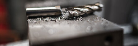

does them = delrin stock and ball end mills?
I might have a 1 1/2-inch 2 flute ball mill..
You two...
To be honest it crossed my mind fleetingly and I dismissed it because I thought a 1.5" ball end mill would be silly expensive. I figured they may have some different geometry in the followers and also - I have a lot of other stuff to do at the moment...
So I ordered them. Sorry to disappoint!

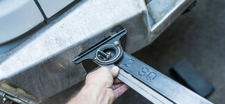

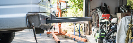

So J is traveling this week so it's a bit harder to get into the garage to work but I've finally wrapped up most of my photo work and I want to get the van done. I am plagued by a desire to tackle things but not the time to finish them all. I'm working on finishing things this year.
So the winch came and wasn't even close to fitting no matter where I put the mount. I ordered up a relocation kit for the control box and got to welding the mount in.
I dug out the bolts that held the stock bumper in place, bead blasted them clean and then chucked them in the lathe to cut them down as there was no space between the winch and bumper.
I love captured nuts. I'm sure you could read that in a few ways - I meant it in the squirrel sense. I hate having to fish around behind a panel to try to hold a nut in place while trying to screw something in the other side. It makes me nuts!
Squirrel!
The fairlead (the "mouth" for the winch that guides the rope in) for a synthetic rope is smooth aluminum as opposed to the rollers that you see with the cable ones. So, fairlead is centered up and the nuts are welded in so the world is just a little better than it was before.

Anyway, while Nadia was busy welding the winch mount into the bumper I decided to look at the frame mounts...
Just a thought on the bumper mounts. It appears to be 2 vertical standoffs going from the bolt plate to the back face of the bumper. Have you thought about adding some horizontal plate to those pieces as a sort of fabricated channel or box (red lines) to help deal with any side loading? I have also heard horror stories of that factory cross-member pulling off during a recovery so maybe a plate picking up a bolt hole in the bottom of the frame rail (purple Line) too?
Just my $0.02
I can't wait to see how the roof rack and rear bumper turns out!

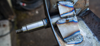

I am so glad you said something Hawk.

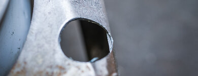

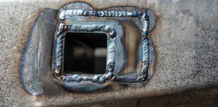

While rusted they don't look like much or worth looking at closer but after some wire brushing...
There's only about two inches of mig bead holding this ear on if you include the two 1/2" welds on the top and bottom. It would certainly have ripped them off had I used the winch in any serious situation.
I've decided to weld some steel from the ear to the frame tube and then go over the factory welds to add some bead and extend the weld.
I try to think in terms of weld cross section as a general way of guessing the strength. My hitch uses a 1/2" pin to hold 12,000lbs so I'm aiming to build up enough bead and bracing to get double that on each side. I may add some more on top and bottom as well and might also try your idea Hawk about another strap that bolts through.

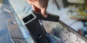

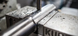

If you ever need followers, I'm happy to make them for you if you supply the material rough cut to size. I have ball end mills from 1/4" up to 1" in 1/8" increments and 1.25, 1.5 and 1.75 as well.
So I got the followers and they aren't a perfect match to the tube - if that's an actual geometry thing I'm not sure. It occurred to me later that I might have been able to buy wood router bits and that they would have worked on Delrin but it's done now.
Gregor
The followers I’ve used in the past were made out of delrin which will size themselves fairly quickly when they start to slide down the tube but I’d expect them to be only slightly undersized if that’s the intent.

First order of business is to drill the tube for the receiver pin. I want this to feel standard and be able to use the standard pins and such. So little by little I drill ever larger holes until I get it to 5/8" and my test pin fits.
Next, because the bumper isn't flat, I cut the tube to the 10 degrees and set it in the back up light opening and tack it in very lightly.
It's all kinds of wonky but now I need to cut some plate to fit in around the receiver and then tack that so I can start to make it a bit more strong.
It now has enough support that I can push, pull and force it into place. Namely to get the pair of them to be square and level.
The initial angle of the supports I took from the seams of the van body and zeroed by digital angle cube. This little ****** is about the fourth most useful tool in my shop. I don't use it much but when I need it it saves me a boat load of time. When it turns off it resets so now you're just seeing the angle of the driveway. I lifted each tube to get them to match and then measured how far apart they were at the bumper and at the ends to get them to be square.
Next up I ordered a swing out kit from 4x4Labs because it was what Ben had and I've quit questioning if Ben did his research - if he got it then I'll want it. We're bad like that. I could have built this spindle from scratch but I have enough going on. It was also eye opening how loose the tolerances where. I'm used to press fit bearings and these all slide in with a loose slip fit. It's sort of nice and it's only a spare tire carrier.
I usually like to really plan things out but I've been winging this bumper and I'm hoping it doesn't bite me in the ***. I will say that I'm enjoying the process of just making without much planning. So I drilled the hole for the spindle without much checking but more based on, "umm, yeah, that looks good" sort of reasoning.
As the hole came close to the face I had to machine a flat but that seemed like a nice way to index the post.
Then the post hit the side at it's 10 degree angle - I'm seeing a theme with the 10 degree thing. So I used my handy cube to tilt the mill head 10 degrees and machined off the end.
Easy Peazy but I was being impatient and opened the vise to pull the spindle before the mill had quit spinning - a no no somewhere in machining 101 - and the end mill touched the part and...
...the bumper just got a bit more expensive! That was my favorite roughing end mill too.

Seeing as my spare is 98lbs I welded up the inside of the end cap, welded the spindle to the bumper inside and outside and then dug in my mild steel bin and welded on two braces. I'm pretty sure the bumper will fail before this does but this sort of fab is out of my wheelhouse so it's an experiment and I'm trying to err on the side of "stronger than needed."
This has also been an amazing exercise in how welds move the metal and how to use that to your advantage and to control it.
The spindle wasn't square but by placing my first welds opposite of where it needed to move I got it to pull into square which was a first for me. I feel like I'm starting to "feel" the way welding works.
More scrap, already mitered. Since the weight of a bike will be pressing down the other side of the receiver will be wanting to lift so I put in a brace that will handle the compressive load.
And another scrap bracing the bumper bracket in compression.
And then I welded in a stop for the outer spindle housing. I haven't even figured out a design for the spare so this might be a mistake but I set it up for 180 of swing. If I need to limit it I'll modify the shell.
I kept moving the heat around, trying to balance the pull, and finish welded the receiver into the bumper.
I then ground the welds flat and primed it with POR-15. It was my first time using it and it's very popular with both car guys and hobby machinists who refinish old tools. At the auto parts store the women who sold it to me told me it's "really strong. Incredibly strong. Like don't put the lid on without cleaning it completely" and she was not joking.
