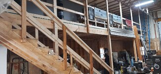

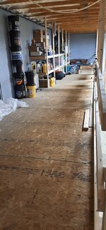

Was asked for more pics of the mezzanine.
D
Diesel Dan
Jul 21, 2013
2,512
TN
Mez header is double 2x12 supported every 12' with double 2x6 and 3rd 2x6 attached to the rafters.
