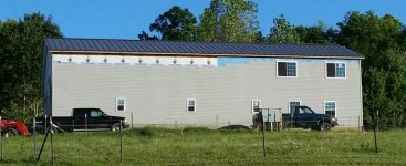

Starting the 18' x 48' lean-to addition.
Painting the rafters, and bottom of osb light blue to keep bugs/birds from nesting. Apparently they think it's the sky.
D
Diesel Dan
Jul 21, 2013
2,506
TN
Lean-to is done....and full:confused:
So glad I found that old scissor lift. Was a life saver on this project.
The blue seems to have worked. Had no issues with insects/bees trying to build nests last summer.

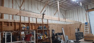

After too many years finally had some spray foam done in the shop. Ceiling and top 8' of the walls. Leaving the bottom 8' so I can do more wiring and then close up with 6" of fiberglass before covering. Foam prices have really jumped in the last 7 yrs!

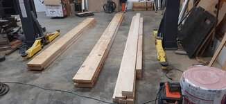

Next project, shop mezzanine.
8' wide x 44'.
Made a double 2x12 header, hung it in one piece, alone.
