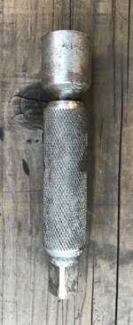

Trying to identify a 6 inch rotating grip extension. The only thing on it is: 41-b-30.200 Is this a military marking? Thanks Mike
31,039
It is not military, per se. It is a Federal Stock Number that was in use from 1934 to 1953. The Treasure Dept was administering the Federal Standard Stock Catalog during that time, and yes, the military technical services were the largest customers. But not the only customers. Very likely military, and very likely wartime, especially if it's not chromed.
If you're not wedded to keeping it, I am putting dibs in for it right now. I have a longer one with the FSN 41-B-311-500.
Re-check the FSN. Are you sure it's not 41-B-311-200?

Yes!! It is 41-b-311.200 The tool had some grunge on just the right spot to make it look like a 0

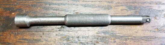

Mike's wartime 1/2-inch drive 5" extension with rotating grip (41-B-311-200) has been united with much gratitude with its bigger brother, a 9" extension with rotating grip (41-B-311-500), in the Lugzsonian. :pimpflash

Thanks, Sonny. It is satisfying. Now if we could only figure out the OEM for these unbranded buggers. I seem to recall proffering APCO-Mossberg, Snap-on, and Williams and neither of them working out exactly right. I'll have to put that on the to-do list.

The first look at it reminded me of Blackhawk. The extension looks really close to their designs of the era.

From the top, bonney, snapon, two blackhawk and the bottom is williams. Does not quite match any of them.
Oldtuleguy
Nov 4, 2017
10,486
Could be made by a company that never sold them to the public. Non catalog item.
