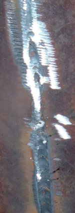

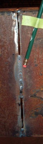

I am not in production on most days but speed and ease is everything. Wire is so good for sheet metal and fab work. No slag, handles poor fit, so fast to fill a gap.

Post a link to one of the China tigs. In the pic above the pencil was to show the fit up of w web slash cut with an existing cut. This was mobile home beam. About 10 and 11 gage in the web and 3/16 in the flanges. I weld hot and could go a little farther with the machine turned down a little but fill this gap and poor fit in all consuming nature that its fully welded for the most part,,,, about 85% or so, faster to weld than fit. Running downand can really make the puddle hang in.

There is some glare and the first pic might be the backside. This is a case of quality being somewhat irrelevant and sacrifice a little appearance for speed and utility.
