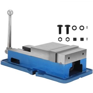

Ok so I have this vevor 6" milling vise on my bridgeport. I mainly use it as a drill press. My old mill the jaw's of the vice had a 3/16" deep 1/8" wide step on the top edge, which made clamping flat sheet metal parts into it to drill and not worry about hitting the base of the vise. I want the same style jaws for this vise. I tried to machine a step it the vise jaws on the mill but the vise material is harder than my HSS Mill. If I can't find any I'll just draw a pair up on solidworks and have a local machine shop make them for me, but buying some already made will be cheaper/easier.
Right now I have some machining parallel's taped onto the vise jaws and it works but when I want to clamp something in to mill it I have to remove them before use and I'd like to have the step jaw's be permanently part of the Vise.
Any leads or suggestions on what I should/can do here.

Make yourself a few sets of soft jaws. Get some mild steel or aluminum bar 1" x 2", cut to any length and put a couple holes in. They are easy to machine any shape into, are cheap enough to ruin and swap in/out in a minute. You can even hold round parts in the vise with a bore in the jaws. Small and large shops do this every day.

-A carbide end mill may cut the hardened steel jaws you now have but doubt the internal corners of the step will be sharp/square as you'd want them to be. Why not get some tool steel (A-2) and make your own? A corner relief can be added with a slitting saw or tiny end mill. Then ask local machine shop to just harden/temper them. Would be less expensive than local shop doing everything. Soft jaws or parallels are SOP too.

I rarely use hard jaws in my milling machine vises. I use aluminum soft jaws for most work. I buy them in bulk from Monster Jaws and then I can just machine whatever profile I want into them as needed. A ten pack of jaws for a standard Kurt vise is less than $200 and will probably last you a decade or more in a home shop. For less than $20/pair I can't justify making my own.
Parallels get used occasionally, but I find the ease of aluminum jaws to just be more effective for my workflow. If they get banged up or damaged, just re-cut the feature. Eventually, they get recycled. Having a set of jaws cut for a vee so a vee block isn't needed is especially handy. I also have some cut with some special profiles so I can hold odd shaped parts or things I wouldn't otherwise be able to grab.

Ok I got some 6" soft jaws off amazon and it worked good. Had to machine bottom of the jaw down to get the bolts to line up vertically. Then I milled a step into them.
