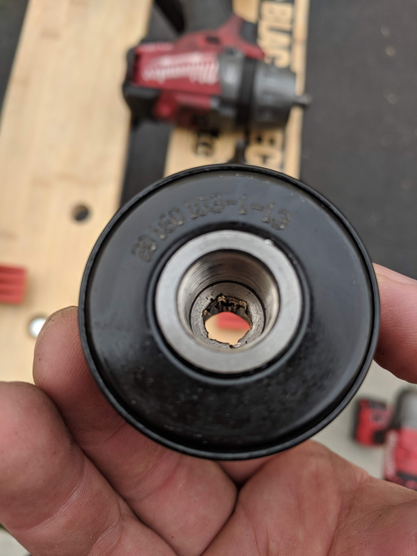

Quick update.
Torx set arrived and lucky me the short end of the torx is not long enough. Pissed. Literally POed. So **** got real. I mean really real.
I skedaddled my *** down to the automotive store. They only carried 1/2 inch T40 sockets, so I stood there thinking to myself 1/2inch seemed like overkill. Screw it, I thought, I don't want to make another trip. Got home, threw socket on my 1/2 in M18 impact, and WHAM screw came right out. Niiiice.
Cool all I gotta do is get this chuck off now. I've watched a few videos and **** looks easy. NOPE. Allen key with a hammer, no luck. Hex socket with a 3/8 M18 impact, no luck. 200% per POed now, I noticed the chuck used a T50 bit. Another trip to the automotive store, zero questions about whether or not a T50 1/2 inch is overkill, and my **** chuck is off. Merry Fing Christmas.
New Rohm chuck is on, and I'm a happy camper.
I never would have though I'd be using a 1/2inch M18 impact to replace a chuck on my drill. Photos below for anyone who wants to have a laugh.

My 1/4" M18 Impact driver (2757-20) was no match for the T40 chuck screw or chuck. I had to resort to the breaker bar...
Finished result. Wobble/Runout is much improved.
