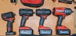

Just to close things out (as far as pix anyway), I found the one pic I had of all four while I was looking for something else:
M12 Stubby --> M18 Mid Torque Gen 2 --> M18 Mid Torque Gen1 --> M18 High Torque (2767)
Honestly, even that pic undersells the size of the 2767 - The Gen 1 mid was a significant reduction in size and improvement in usability. but the Gen2 crossed a threshold that puts it very-nearly at the Stubby level when running a 3.0 battery. I'll re-post the pic from earlier to make it easy:
The Gen2 is definitely heavier and bigger than the Stubby, but almost feels like an M18 Stubby with some pretty-whopping power, where the Gen 1 felt like a smaller/lighter 2767.
I don't live in the rust-belt, so haven't had to deal with a truly-rusty scenario.

I am also working on old Porsches, and have been acquiring the special tools as needed (e.g. cam nut holder and Crowfoot). It is frustrating to spend money on tools that I use once or twice, but sometimes there is No Substitute for having the right tool for the job.
The reason I wound up with a Stubby, a Mid and a High was that an old BMW came home to me (long story I'll spare you) and I had the notion to get it back where it should be. But it had gotten pretty damn rusty. I was already at the edge of my Craftsman C3 tools and decided to transition to Milwaukee. Originally I got a 2767 and the Stubby, but then found a smokin' deal on the Mid (Gen1) before the 2767 even arrived.
I did a few things on the car, all of which worked fine with the Mid, but ultimately decided there was too much to do for me and passed it along to a police officer who wanted a project to work on with his elderly father.
As I've mentioned, none of the work I did on the other family cars exceeded the capabilities of the Mid, so I sold the Gen1 and the 2767 and bought the Gen2 since the size, tri-lights and auto-mode were all a step up from the Gen1. So I run the Stubby and the Mid.
If the money isn't a big deal, I'd probably have all three. For you, rust is enough justification. But space and money are something I keep track of, and the Home Depot less than 10 minutes away pretty reliably stocks the 2767 if I'm ever put in the situation where I need to get one.
I promise I'll shut up now ;)
