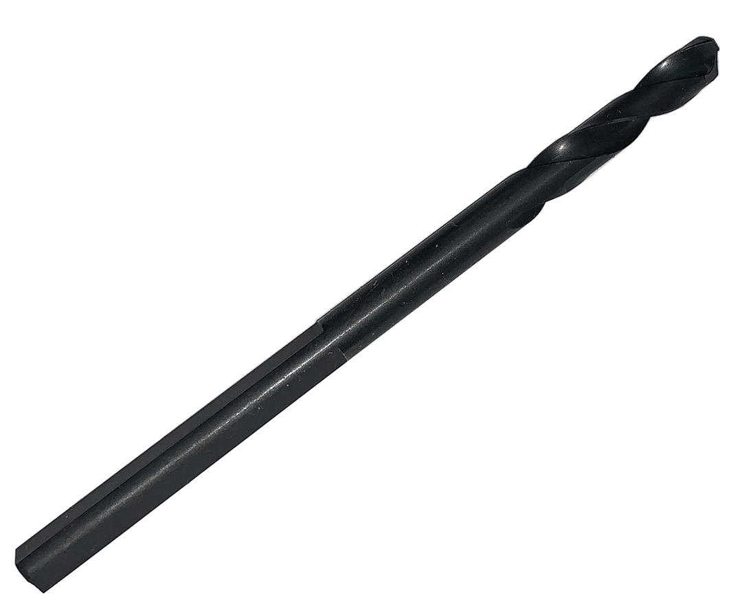

I've got an older hole saw kit and was drilling some sheet metal and broke two pilot bits before finishing the job probably because I did not stay perfectly perpendicular to the material
The bits that come in the kit are high speed steel and run about $10
Milwaukee also has a carbide tipped bit that runs about $3
I mostly use the kit for wood and thin metal
Is the HSS bit worth 3 times the price for my purposes or should I refill the kit with carbide tipped bits?

So I drill the hole with a regular drill bit and replaced the pilot bit with a piece of metal rod (bolt would work I'm sure) and no more broken bits. Just my thoughts.

I have been doing exactly that for probably 50 years..... works great.... :thumbup: :thumbup:

The predrill and use a plain rod is a pretty useful way to improve the quality of cut, particularly on bigger sizes of holesaw used with handheld drills. The normal pilot bit tends to get moved about a bit if/when the teeth on the holesaw first start to bite and can chew into the side of the pilot hole, allowing the holesaw to wander until it has cut deep enough to guide on the outer edge, rather than on the pilot drill.
If I need accuracy (it's a relative term: we are talking holesaws) on site, I'll usually holesaw a hole through a piece of scrap , clamp the scrap to the desired hole location, take the pilot bit out of the holesaw, and cut the hole using the clamped-on scrap as the guide/locator. This method is also very useful when you need to cut a disk of metal without a hole in the middle. In the shop, I'll normally just use the drill press if practicable.
I've used steel, wood and MDF as the scrap material. MDF is what I use when it's handy, though steel is obviously better when there are a large number of holes needed and particularly when a cutting lube is required.

I also drill a pilot hole, but just use the hole saw arbor. After the pilot is drilled I put the hole saw on. Every single time I've broken a pilot bit, it's been when the pilot bit broke through and the saw slammed into whatever material I'm drilling through.
