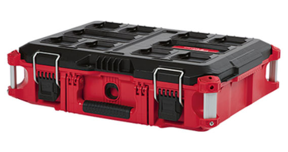

So... I’ve been thinking about tool storage in a tropical environment. One idea I had was to create drawers out of airtight cases - something similar to a pelican case...

Not sure airtight will yield the protection either way - when you open the case and close it, you are trapping the same moist air inside the case, right?
I think even if those cases are not rated as airtight, using them in combination with a VCI block inside would yield satisfactory results.

I've got a couple dozen pieces of Packout. Use them strictly for armorer parts and tools. And ammo storage. Never given a thought whether they're truly airtight, or not.
If I had an empty one and if it we weren't in a cold snap, I could try a dunk test.
If any of them are, I would suspect it'd be the cooler that they just released (48-22-8460). Haven't seen one in the flesh yet, but it appears to be very similar to the compact tool box model 48-22-8422, of which I have at least a dozen.
Interested to see if there's a different seal on the cooler. Specs on the seal are the same, so I don't know what the difference would be.

It does have a gasket like the Milwaukee pack out boxes. If you dead-head the vacuum the top of the box will **** down a good half inch, but will not leak around the lid gasket. Check out the photos there and see if my build answers your questions.

Hydrosorbent 40g silica gel. Google it; about $6 each.
We lived on a cruising sailboat for about 15 years; kept our DVDs (and cameras, and hand held electronics) in pelican cases (with the DVDs in thin breathable sleeves) when not being used. Watch the sight glass every time you open the case, and replace them each time when needed. Think we only lost 2 DVDs (out of hundreds) due to moisture getting in-between the layers, and handheld electronics, sextants, and other items were corrosion free after we moved ashore.
Good thing about these is that once they **** up the moisture in the case you can recharge them in your oven. Pretty much indefinitely.
We moved off the boat a decade ago; and as I sit here I have a closet door open with a dozen of those pelican cases in it staring back at me... and a few of those are filled with several dozen of those silica gel enclosures... don't need much desiccant in the desert...
Note that there is now (now they tell me?) some concern with the older silica gel being a potential carcinogen - so if you find some old ones, don't eat them, or grind them into powder and breathe the dust.

Tropical as in Hawaii... I'm building a tiny shop there this summer... Details.
The challenge is this:
I want to store basic hand tools along with the following:
1. cordless drill/driver
2. Track saw
3. router
4. sander
With the challenge being, I'm only gonna be there 4-months out of the year for the next couple of years... and I don't want things to corrode to **** while I'm not there...
The reason I thought of Packouts is that they are actually available on the island and I could save a ton on shipping. Add some sort of silica and I just might be in business...
I need to do some testing for sure.
This is what I came here to say. Here's one place that sells them: https://www.theruststore.com/VCI-C12.aspx Note that they also sell VCI bags and sheet film that may be even better for long term storage in Hawaii, see the link on the left side of the page.

If moisture gets to it especially salt air it will rust. The only way I have seen to store tools in a salty air environment the only way is to coat it in cosmoline and wrap them in wax paper.. I grew up in San Fransisco and Honolulu. Tools rusted in both places. My dad would spray his tools with WD40 and occasionally coat them with motor oil. Especially if he didn't use them much.

...I think even if those cases are not rated as airtight, using them in combination with a VCI block inside would yield satisfactory results.
Exactly that. If not a block, you can buy a roll of VCI paper, and put a sheet on the bottom of the case. You probably already have VCI paper or bags. The tacky sheets of stuff that brake rotors come packed in. That's VCI.
It's possible they're as airtight as a Pelican, but I doubt it. They don't have a pressure relief valve. Having the lid **** in under vacuum is a good sign though.

The old silica gel had cobalt chloride indicator (changes from blue when dry to pink when wet). The new stuff goes from orange when dry to dark green when wet, and is supposedly safer. But if the cobalt isn't escaping, it's not a real issue. The only real risk I am aware of if if you eat the pellets.
Both VCI and desiccant are good options. Both require a reasonably well sealed case to last. VCI has the potential to inhibit corrosion for longer, but silica gel can protect things that VCI doesn't.
If we're talking only about tools, and metal corrosion, VCI is your better bet. If we're talking about protecting photo gear, DVDs, or computer equipment, then desiccant will be the better choice. VCI can leave an almost invisible film on surfaces, and camera lenses don't like that.
Oh, and if you want a sealed container on the cheap, buy 5 gallon buckets and install Gamma screw on lids.

I have a stack of Milwaukee boxes I use for my home remodel side business. I leave them in the truck sometimes or get caught in storms I am super happy with how dry they keep my tools. Working in the winter time, I leave them out on a job site occasionally when it gets below freezing and I do not have frosty tools. Everything stays dry.
That said- I don’t leave them out on a regular basis and I’m sure some dessicant packs certainly wouldn’t hurt.

Get a cheap box, something with rounded edges. Doesn't have to have a rubber gasket (actually you want it without a gasket so you can get all the air out). Then get the vacuum bags made for clothes. They are amazing. They get enough air out that it will make a pile of sweaters feel like a brick. They have lots of different sizes and usually come in variety packs. I guarantee if you seal it up correctly you could put them at the bottom of a pool for 4 months and not have a leak. They are basically a big ziplock back with a vacuum port. For extra protection you can duct tape the seal and port before putting them away.

A quick update on my Packout experiment:
And Small Craft, I 100% expect you to make fun of me when I come home to Kauai with a plastic bin full of rust...

Pretty good!

I live in Hawaii also. Its not as big of a deal as you might expect to keep the containers moisture free, the appropriate amount of silica gel will do it just fine. I use some storage containers from ziploc that have a foam seal around the edge, https://www.amazon.com/gp/product/B00MWTJWXS/?tag=atomicindus08-20, and one of these in each, https://www.amazon.com/gp/product/B000H0XFCS/?tag=atomicindus08-20.
That should take care of the long-term-storage portion.
Aside from that, the occasional WD-40 soak and wipe does the trick. All of the above said, if you live on the windward side of the island just be prepared for everything to rust. There isn't much you can do about it aside from using only stainless steel for everything, just pretend like you are living on a boat. If you are not on the windward side, and don't have to deal with air directly off the ocean, what I mentioned above should work well.
If you want something a little more scale-able, get a 20' shipping container dropped on your property and just put a dehumidifier in it and stick the drain through the floor, that's worked well for me so far.
