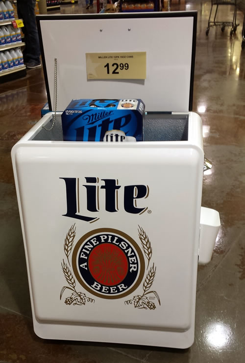

I have a mini-fridge (like the ones kids use in dorm rooms) the wife bought me for my b-day a few years back. I built a stand for it and placed inside the storage closet of my attached garage. In the summer it would never really keep anything cold, maybe "cool" at the best. I attributed it to being in that hot-*** room and maybe it was designed to be more "indoors"? Is it too close to the wall maybe?
Here's a pic:
Since it never really worked for it's intended purpose I just unplugged it and it's been sitting idle for a couple of years. I'd like to move it to my new detached shop, but I wonder if it will suffer the same fate since that structure only has roof insulation and gets pretty hot in the summer months.
Thoughts?

Those "super minis" typically don't have a refrigeration system- they just use thermoelectric coolers. Those vents on the side suggest that yours is like that. TEC systems are not as powerful, I get lots of complaints on them that turn out to be "operating within mfg specs".
Does yours have a compressor?

Does it even have a compressor or is it one like in a RV. The ones from RV's use ammonia and it is heated by either an electric element or a LP gas flame. The ammonia in these tends to cristalise at the top of the coils after a while and reduce their efficiency. The fix for this is to disconnect them and turn them upside down and let them sit a few days, tapping on the coils with a soft mallet will help with the more stubborn ones. I have the reefer and freezer from my old moter home in my office plugged in and it keeps every thing as cold as I want it on a medium setting, it is probably 40 years old and when it starts to act up or when I need to defrost it I just tip it over and let it sit, then good as new.

If it is one of the newer styles with the peltier like cooling setups they can't cool as well as a regular compressor setups. I can't think of the correct naming right now but they are common on minis and wine coolers.

Pelter chip modules are usually 12 to 15 volt DC, and are found in portable coolers and ice chests. I had a 12V model I used when I was a trucker. The cooler would last about a year or so before the fan would go out and it would stop cooling. I would give them to a friend who would remove the chips from the cooler and make CPU cooling modules for computers. A Pelter chip cooler will either cool or heat, depending on the flow of current.

that NU COOL fridge does not have a compressor. It is the TEC (thermo-electric). Remove the back covers and vacuum it clean, as dirt and dust will effect it's efficiency. You will find that they don't do a very good job at keeping things cold. If you want your beer cold then you should look into getting a fridge with a compressor.
