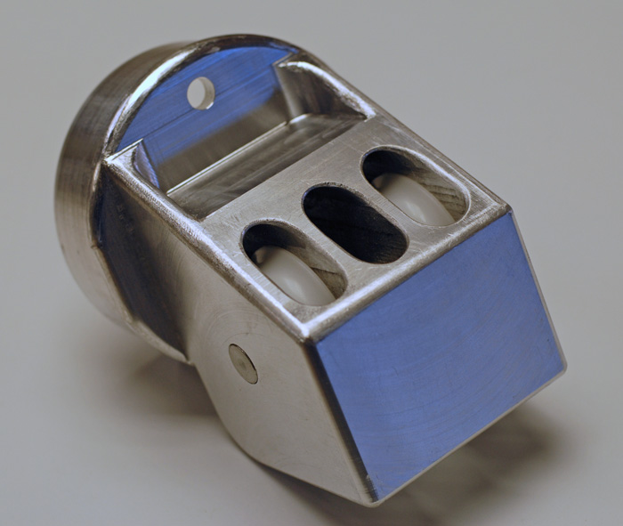

Not suggesting the OP needs the same size machines that I bought, but my mill and lathe together cost me $2,000. That was when I was ~70 years old; I had never operated a lathe or mill before. Yeah, I waited a long time to get started. :) These machines are rugged enough to actually do a job.
Shown is the very first part I ever made on a mill, an end fitting for a 4" sailboat boom. Made almost enough on that first part to pay for the mill.

Nothing wrong with the smaller machines, just have to work within their limitations:
