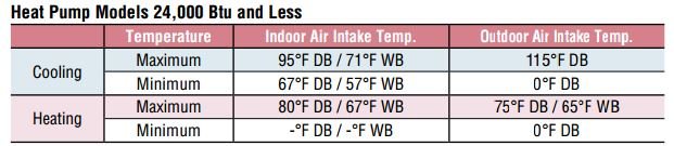

I just bought a Gree Crown 12kbtu mini split to install in a beach cottage on Lake Huron, according to the submittal sheet it will still produce 10kbtu of heat at -22F. Place has a 9kbtu electric wall heater that should never have to be used... I'll do a post on it when it gets installed since there is not much on the hyper heat units on here.
I will admit, I am not an HVAC guy, but checking the spec sheet on that unit is see this. which does not line up with what you quoted.

At -22 I see nothing. At 17* I see 8500btu (COP of 2 X 3414 btu/kw +some fudge I guess). The max 12kbtu number confuses me. Heat pumps are tested at the 47 & 17* temps. If I was basing the decision on low temp heating I would want to see the output curve across the temp range. Gree has that and it should be available. The Mitsu chart that TOW1 posted is what you want. Low temp heat pump operation is or can be the classic example of "figures don't lie, but liars figure." Mitsubishi and Fujitsu do the low temp heat reliably. The other thing is that they both have real tech support and parts. You pay for it. If the Gree is cheap enough and mini-splits become less and less expensive they may join the "disposable appliance" category where the are just replaced rather than being fixed.

Do you guys have a problem looking at page 2 of the submittal that wizard posted? - the output across the temperature range is there in black and white, more data than is available from most manufacturers. I have not quite figured out the difference between maximum performance shown on the submittal said vs the rated performance, it looks to be differences based on inlet air temps and may also have to do with losses associated with defrost at low temps?
The guy with the Gree is not the guy with the garage.

I think I'm going with the Panasonic http://www.alpinehomeair.com/viewproduct.cfm?productID=453068956
Unless someone has negative info about Panasonic that I should be aware of.
Not the best in the industry for low ambient heating. You will need auxiliary heating for those really cold days/nights.

The numbers to look at are the minimum temp for heating. Are you still in St. Louis ? So the Mitsubishi that goes to below zero is better than the Panasonic (which looks better than the typical unit that goes to 5f or so.). I would think in St. Louis that you don't have many below zero F days? Will you have any critical things like water pipes that could freeze on a rare super cold day?
