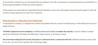

I purchased a Mr Slim 6 years ago from eComfort and paid a local Mitsu dealer to come out and get it started up. I then registered for the warranty online. but fortunately, I never had a problem and the warranty is now expired.
I just now checked the eComfort website and it seems that is still the way to go, IF you feel you need to have a warranty. Personally, I thought it was a good idea to have a professional/licensed contractor check my system over and get it up and running for $300. But I made sure I had a couple of contractors lined up to do the job before I purchased the equipment.
