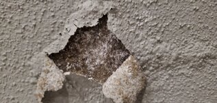

The other PITA thing about how this garage is setup is that concrete wall forces all the outlets to be up high.
For reference the concrete portion is 42" tall and the outlets are 7'
Also, the ground outside is level with the top of the concrete wall.
Close up shots of this section of wall from the pic above. Had this wall painted when we had the floor epoxied(2 yrs ago). This is the only section of wall that has the paint bubbling up and staining. You can also see where the floor and wall meet appears to be deteriorating.
madcoder
Aug 9, 2013
24
North Carolina
Bumping this thread as water is still coming in through the walls.
I fixed the drainage issue outside, sealed every crack I could find, replaced all weatherstripping on my garage door, and run a dehumidifier 24/7.
The humidity in there is great but the wall is still absorbing water from outside. I'm guessing this is because the ground water is going to be there no matter what and the outside wall isn't waterproofed.
I've read a solution is painting the interior wall with a "slurry" that's made for waterproofing. Will this cause problems with water getting trapped in the wall since it has no place to escape now?

I would dig down to the footing, put in drain tile and drain to a low spot or a sump pump. While the dirt is pulled away, clean the foundation well and seal it properly on the outside..

What @PoorUB said--and also add some outside insulation while the wall is exposed. Use styrofoam with the applied gravel finish for the exposed part of the insulation. Then insulate the rest of the building. Heating/cooling without insulation is throwing money at a problem.
