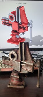

It is a start of the new project. This time it will be a miniature pinch bug vise. Full-sized original was made in Acron Ohio. The vise is rather unusual. It has some unique features like when you tighten the screw closing jaws you simultaneously stiffen the entire assembly. It also can be positioned vertically and tilted or horizontally and swiveled.
The starting is the same as with previously done miniature Wilton vises. I make 3d model of the vise then 3d print parts and check how it fit together. Hopefully, this project will be complete faster than the previous one.
Thanks.

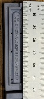

I 3d printed all molds. Dynamic jaw mold I printed 6 or 7 times. I lost count. There were several issues I addressed. I started with a few types of flexible resins although I was not sure it will give me an advantage. The sought was flexibility will make removal from the mold easy. However I found it is also easy to remove the wax from rifid mold. Another issue was inconsistent geometry. It required several calibrations. Finally, I picked a basic grey resin, found proper exposure time plus determined the percentage of shrinking, and compensated for it. Additional challenge is to find proper temperature and speed of wax injection. I am close to this, but still not there. I am still not happy with the letters on the dynamic jaw. The rest of work is done, and wax models look good.
