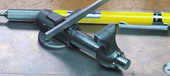

Today 1/8" hex brass stock arrived fron PM research, and I immediately started making bolts that clamp the vise on the swiveling base. I played with serrated jaws as well. Not sure I will keep the brass ones or will make it from steel. I also need sharper point to cut such a small serrations.

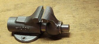

After a few month of waiting I received my steel cast parts. I am machining it now and plan to make a dozen miniature vises soon. In addition I make a video of every operation, and will upload it to YouTube while finished.

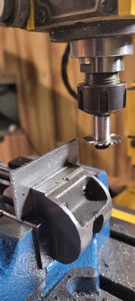

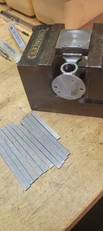

Slow progress. Due to tight tolerances it is hard to make smooth operations with key installed. But I will make it work. All swiveling bases machined, all stationary jaws reamed and key slots are done as well. I am cutting key slots in the round part of moving jaw.

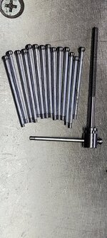

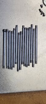

Yesterday I machined tubes OD to 0.374" 1 5hou is a good tolerance for the moving jaw. I also finished all nuts and cleaned cast nut housings. Today I cut 3/32"key stock, and check how front jaw moves. I also ream the front jaw cast part then press fit it to the tube.. after this operation finished I will turn the pocket to accomodate the main screw.

I drilled #62 holes in the moving jaw. Now tapping #00-90 is following. I use an extra precaution while tapping. Little mistake can not only cause broken tap but also a headache of removing it from the part. While taps are done next step is retaining plate.

I purchased forming taps instead of cutting one I had. I also made a small jig to keep the tap aligned to the hole. I tried with the spindle of the drill press while driving belt is out but the spindle is too massive to feel what is the torque on the tap plus the quill is sring loaded, and it does not helps. With this new jig I am able to form all tiny threads without braking the tap. Handling this little screws #00-90 is another problem. I already lost two. There is no chance I will ever find it, and they aren't cheap. After I finish with plates and threads I will mill both jaws to accomodate serrated inserts.

All jaws milled. Now I will tap a pair of #0-80 threads in each jaw and will make serrated inserts with counter bores.
