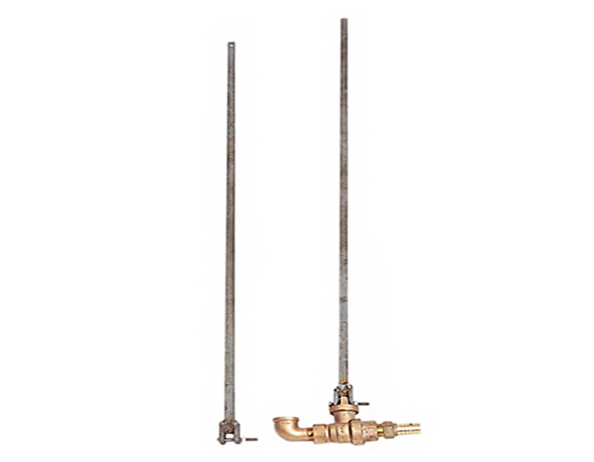

No experience with that, but seems expensive for what it is. Why not just use a PVC ball valve and fab up a tool to turn the handle? I use a piece of 1-1/2" PVC with a notch cut in the end to accept the ball valve handle.

I did install PCV valve between the two outdoor water lines. I know the one line going to the farm house leaks, no real idea where the valve is buried now. Hence thinking about the above ground base/cover for locating.

I'd install the PVC Ball valve below ground, then install a piece of 4" PVC from the ground level to the valve, use the 1-1/2" PVC "tool" to operate the ball valve. The 4" PVC get's a female adapter and a screw in plug at ground level. Would do the same as that $400 valve for $25...

Because PVC ball valves ****. Few years from now when he goes to turn the handle, the valve is stuck, the handle tabs snap off, and you're digging again. Have a couple of 2" on my irrig pump and they have each lost half the handle and are just about frozen and it takes a pipe wrench to turn them. Next time its gonna be genuine Chinese stainless.
The Miraco above is just a curb stop valve, and that's probably the type of valve you should use if you're going to bury it. You can buy or
make a custom key for it out of steel.
