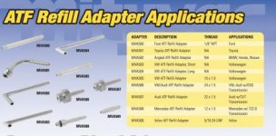

Here are all the adapter's it comes with.
Some of them are just angled tubes, but it can be handy comparing to jamming some vinyl hoses into the fill port.
