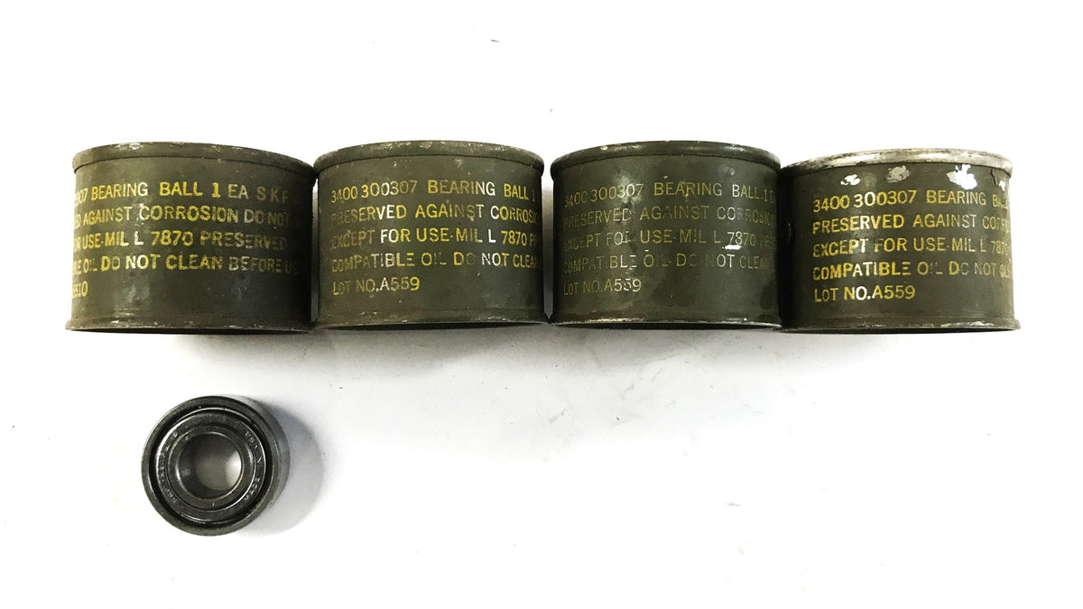

Can anyone tell me what the modern replacement would be for this old ball bearing (probably from late 1930s?
It is an SKF and has "No FL-15" stamped on it. Also has stamped "Made in USA",
on the inner ring it looks like it has "DC" and "15"
Wamsutta

Give me the measurements (in millimeters) and I'll give you the part number.
1. Inside Diameter
2. Outside Diameter
3. Width

These are the dimensions I get with my cheap caliper
Outer = 35.05 mm
Inner = 14.96 mm
Width = 12.35 mm

No is shorthand for number: so its PN FL15.
NTN looks to have what you need:
noid
Jul 15, 2010
1,341
8502 and 87500 are extended inner race bearings
The fl15 doesn't appear to have a extended inner race.
This one should do?

This one should do?
It should be a extended inner race as well, the drawing is questionable.

How about actual FL15's???

Outer = 35.05 mm = 1.3799"
Inner = 14.96 mm = 0.5889"
Width = 12.35 mm = 0.4862"
I think your caliper might be reading a slightly wider than it should be.
1622 is the size I came up with.
