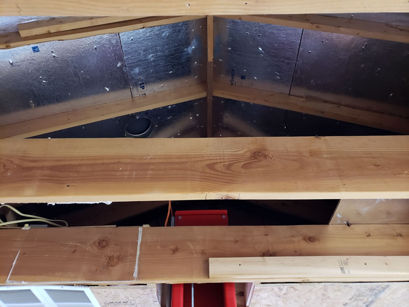

ee8461313484bfa88534bdf5a4b45ea6.jpg34bea3337ea389daec509fcbe822ee4b.jpg3b216e4f953cb44e90931a8c15459f67.jpg
Finally got the plans back from the engineer. Of course it’s over engineered. Same design my contractor suggested except with different materials. He suggest using 2x14 LVLs instead of 2x10 for the rafters. The contractor and I think this is overkill. Also it quadrupoles my material cost [emoji19]
kbs2244
Nov 11, 2006
14,065
Your engineer has gone completely conventual on you.
And over specified in the process.
(He isn't paying for material>)
Rafters with collar ties only get you as high as the collar ties.
If you go with a roof BEAM under the roof BOARD that the trusses now give you,
you will have a ceiling that goes to the peak.
But the ends of the beam will need support.
And it will need to be threaded through the existing trusses.
I have seen them threaded through the vents in the gable end walls.
(Do some research. It might need some imagnation.)
The wall end of the beam is easy enough with some extra 2x4's as a support post.
The other in will need a support post or sistered trusses.
Roof beams are often ignored as a roofing support system.
Since WW II rafters and roof boards have become "conventual"
But roof beams are the way log cabins were built.

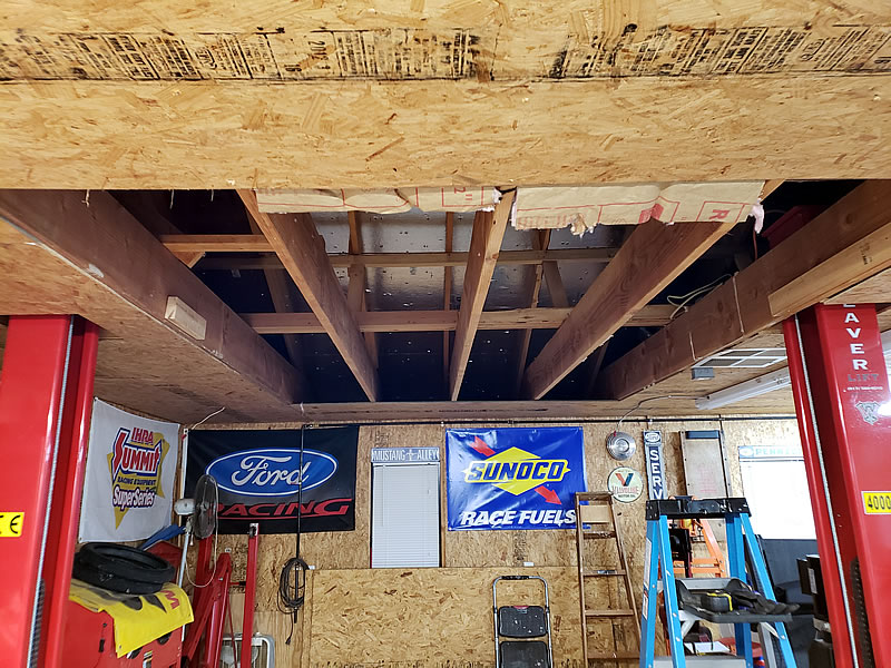

R6 Racer
Feb 21, 2010
1,632
Northern Ontario Canada
I recently finished mine. Very similar
Had an engineer do up the design & place the order with the truss company
That cost me 500.
The 5 trusses were 2500., delivered
14 sheets of 5/8" plywood sheeting was 500
Beer & pizza For 3 friends after the install was 200.
Engineers inspection & job sign off was another 100.
Total cost was right around $4000.
The new scissor trusses came in 3 pieces. 2 half trusses that butted against each other in the center & 1 center truss that covered half of each of the half trusses.
The tails of the new scissor trusses were tucked in over each end wall & then both were lifted up beside the old truss butting against each other in the center. Then the center piece was the attached to both of the two halves.
I do hope I'm being clear.
The 5 new scissor trusses were all attached along side of the existing flat bottom trusses. The 2 outside ones were installed on the inside of the 2 existing outside trusses. After they were all installed I cut out the bottom part of the 3 center old flat bottom trusses that hung below the new scissor trusses. The whole opening that I just exposed was then completely sheeted with 5/8" plywood.
There was also a bunch of other things that were required by the engineer like the 2800+ nails that had to be used & installed in a very specific pattern As well as a bunch of blocking & wind lashing that was needed.
My trusses are 24" on center & my opening is 8' wide x 31' long & goes from 10'6" tall at the ends to 14'6" tall in the center. The roof has a 6/12 pitch & the inside of the scissor trussed or my ceiling has a 3/12 pitch.
Steve
Oh, & my snow load requirements are quite high.
