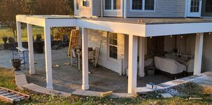

Alright, well I've got a new focus for a bit - building a new custom lamp post out front. For years there was an old ugly fixture that we decommissioned electrically awhile ago. A few years back when we were doing the sidewalk I ran conduit out with the intention of eventually building up a new nicer one. That time has finally come.
It'll look like this, which matches columns on the front of the house that support the porch. The black fixture on the top of the column is the lamp itself.
The plan is to excavate a bit and create a small concrete pad, then build it up from there with some internal 4x4 posts. I'll face the posts with plywood and then build a "face frame" box around it. I should be able to build the face frame in the shop and be able to use hidden pocket screws & glue to keep the joints all staying really tight, as usually outdoor trim and carpentry starts showing joint gaps over time which don't look good. Here's the look I'm going to be trying to match:
So I started by digging out the concrete pad. Centered around the electrical service which will run up through the center and be hidden. Also had to rip out the old lamp post.
Created a 24" square form. One thing is for sure is I really don't know what I'm doing here, sorta winging it. I had one bag and then I recalculated that it really needs closer to 3 bags of concrete. So, will pick those up and hopefully get the concrete mixed and poured and screeded off today so that the little mini pad can cure for the next several days. I'll feel more comfortable once we get into the woodworking portion of the project, but I am anchoring the posts to the pad using post brackets so definitely need the pad to cure up enough to be able to grip the big Simpson anchor screws.
In the meantime, my mind is always at least half in my shop, so I've been modeling up a workstation to build for my pocket hole jig. Lots of designs out there, all of them are pretty similar. Mine will also be pretty similar as well, but take the features I like from others. I should be able to build this out of scraps again (win!), here's what I've got so far:
The two wings on each side are going to be hinged on the back so that the inside can be used for storage. I'm thinking screws on the left and accessories/clamps/bits on the right. Having a front fence just helps with squaring and supporting the material and the T-track is there to be able to have an adjustable stop piece for when that is appropriate. I'll make the stop slotted so it can be moved backwards when not being used but also then be a guide on the other side of the workpiece (think of a long cabinet side and how tippy it wants to be when setting up in these jigs). Then there's a handle for carrying and hanging on the ceiling, and also a pattern of 4 holes that lines up with the MFT 4x96 20mm hole pattern so that I can just pop in 4 dogs and it's secure on the workbench. The only thing not shown is the jig itself since there's no point in modeling that up. Maybe I'll be able to get this build going over the next couple of days. It's not super complicated but details matter on this one to make sure all the right surfaces line up properly.
Adam

Look into MDO instead of plywood. And your concrete pad should be higher than surrounding ground so you're not weed whacking the post.

Good point on the MDO. I have some PT plywood but the MDO would result in a much smoother / nicer surface, I didn't realize it was used a lot in outdoor applications. These will get a heavy coat of exterior paint, so they will be protected from that as well. I'll look into raising the height of the pad but probably can't go too much higher. I plan to edge around the pad with some decorative brick edging which should also keep the grass away from it.

I took the advice from Toolfool and added an extension to the form to bring it up a couple more inches. Love the suggestions, and I always try to consider good feedback! Had to get one more bag of concrete and then mixed it up and dumped it in. I forgot how much not-fun it was mixing up bags of concrete by hand.
So that'll dry and then I'll be able to start laying out the inside structure of the lamp post.

Today was spent on the lamp column. First set the 4 posts. Probably a better way to go about this but this was my approach. I found that a lot of finicky work was necessary to get all 4 posts perfectly set relative to each other so that the column remained upright and square in all three dimensions. I found making some stretchers out of scrap stock and securing the posts as they were installed helped a lot to keep my measurements consistent.
When it came time to face them off with the MDO plywood, it wouldn't sit flush at the bottom on two sides due to the brackets and screw heads, so I had to clearance away 1/8" or so of material. I initially set up to run a dado stack on my saw, but since I didn't have the dado width brake cartridge the saw wouldn't let me run that combo. Oh well gotta order one of those, and so then I decided to rout the material way using an auxiliary base and my trim router.
Then just installed the 4 sides and lined them up, being sure to leave a gap at the bottom so they don't touch the ground and wick up moisture.
Next step is to start building up the face-frame overlay. Going to try to do this as one piece so that I can pocket hole the corner joints internally and keep them tight forever, then slide it down over the top (which is why it needed to be straight and square). Then a plywood topper, a coat of paint and then the lamp gets installed.

Jumping back into the outdoor lamp project, time to do the face frame decorative part of the column. Have some relatively straight GC PT 1x4s that I trim to size. My plan is to pocket hole into 4 frames and then assemble them in the shop, then slide it over the column and nail into place w/ SS 16g trim nails.
This is why I wanted to finish up the pocket jig workstation, it made things a breeze.
The MFT top really shines here along with the accessories. Squaring things up and clamping parts in place are much easier than before.
It was pretty simple stuff but took time as I was very meticulous with measurements of the column and triple checking sizing. I'm going to screw and glue these together and want it to slide over the column like a glove, just right but not too tight or loose.

Tomorrow job is to sand the exterior and then fit it over the column and tack it into place. I spent a lot of time on my measurements and it's all glued up now so if this doesn't slide right over then I'm going to lose my ****.

Skipped a few steps I think on the lamp post, but I've been chipping away at it. Finally got paint on it and installed and hooked up the lamp fixture. Just in time for winter cuz I think snow comes later this week. Will give me light when I need to go outside and shovel the driveway at 4am!
