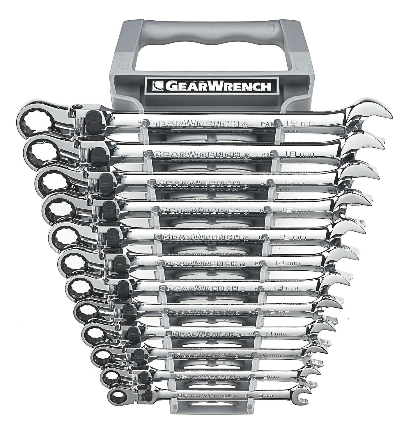

I am needing to buy a new wrench set. My old set is just cobbled together from years of... well I don't know what. Hand me downs? Lousy walmart sets? Anyway its kind of lousy, and its incomplete. I'm always running into a situation where I'm needing a wrench I don't have. I just snapped the head off a Greatneck brand crescent wrench, and that's the last straw. I'm buying a new set.
I can't really afford Snap-On, SK, Armstrong, etc at this stage. But I can afford Gearwrench. If you've got another brand recommendation in that price range, that will be fine too. But it doesn't actually look like most sets that are being sold these days, are really going to remedy my problem. Take this one for example:
http://www.ebay.com/itm/GearWrench-...919636?hash=item3d2764c194:g:u-IAAOSwPCVX8MLM
Right now I am in need of a 21mm wrench. No 21mm in that set. It stops at 17mm. Or if I bought them separate, and went with this metric set. Still no 21mm.
http://www.ebay.com/itm/GearWrench-...:g:PQoAAOSwepJXZ-AG&item=331886625864&vxp=mtr
And that's something I've noticed for a while now. Doesn't anyone sell a more complete set of wrenches? Its a bit annoying that they just think that their lacking set is everything you'll need. I'd like it to go from about 6mm to 28mm. Same for standard side of things.

Alright thanks for the recommendations everyone. Much appreciated. Went with a gearwrench set, and I'll just fill in what is missing by buying them individually.
But now I have a few questions regarding all the different variations. In regards to flex head, non flex head, ratcheting, open face, stubby, etc.
Is there a "best" overall type? To me, it seems like ideally, you'd want a complete set of open face on one end, and ratcheting flex head on the other end. If you have that, do you really need the any of the other types? Would you sometimes run into a situation where you'd say "Dang, if only this flex head was not a flex head. But still ratcheted".
Or would there ever be a time when you'd say "If only I had the old style closed face, that didn't ratchet".
I'm trying to figure out the best way I can cover the most ground.

Flex head is your best bet, reversible flex head is the perfect combo though. While I've never encountered a problem, it is possible to use a non reversible wrench to loosen a fastener 90% of the way off, but then because of clearance issues get stuck and unable to remove the wrench. Then, without the option of reversing the wrench, you cannot tighten it back down to get the wrench out. In the long run, you will most likely end up like many of us and own 4-5 different types of the same size ratchet wrench. (stubby, 0* offset, flex, reversible, XL double box end)

i just purchased this set a couple of weeks ago. It is FANTASTIC!.. The open end fits fasteners VERY well, the ratcheting end is smaller than the standard GearWrench ratcheting wrenches so it will fit into tighter places. I have yet to do a Full review of my own but it's coming. Click the picture for more info. I paid $214.00 for them on Amazon they were originally 365 when they first came out. You can get the set that includes 21mm as well.
The honest answer to these questions is that 'yes it matters', but only in context of what else you have to work with, what $$ compensation system looks like, what your time value of money looks like, etc.
So, in a mobile toolkit, I say avoid ratcheting/open end combo if thats the only thing you have. There is a high risk of two bad things happening--1) breaking a ratchet and/or 2) either spreading the jaw. This can happen for inability to get the oversized box end on the fastener, forcing you to use the jaw; or it could happen because you broke with the ratchet first and it lost the battle.
In that case, a double box/ratchet (eg, armstrong, xdh, or gw gearbox type) gives you more safe options Open ends are rarely needed and usually a ajdustable/pierswrench/or plier in a pinch will do the job. Non of those will typicically break a recessed hex that is really on there (they are all vastly more bulky).
The one type of tool approach that might sqeak out of a couple jams is FD+ type open ends (proto asd,facom, sk, snap on...etc all similar). But you are paying truck prices (150+up for sets). But this is also sub-optimal as these systems in normal use tend to mark/damage fittings--especially in at the limit use which is the only time they are useful.
The rest of it is about saving time...and for some people time is money. For others its not really worth hundres to save 15% on a speed test for a 45 minute oil change. But if your job is dong 40 such procedures a week, the 15% payraise is maybe worth (50 weeks a years...etc).
There is also to simpler zen / less tools mantra of not having to assemble, disassemble, put away, etc small 1/4 drive sockets all day (and tool control all those 8 or 10mm droppers :willy_nil:willy_nil).
so this is why in general the context matters, and as your own ambitions or experience grow you will develop your own list of tools that critically simplify or make more convenient thing that otherwise may be labeled as "brain damage"... :bounce::bounce:

The only type that will work all the time is a regular combination wrench. That's where you need to start.
Ratcheting wrenches are a convenience. The larger box end will often not fit in confined areas, and the ratchet is not that strong. Flex head and reversible offset wrenches mitigate that some, but the head is still larger.
IMO, the best do all is something like the Gearwrench gearbox (closed 12pt on one end, ratcheting 12pt on the other), since you seldom need an open end. They're expensive though.
This would be the correct answer to the question and good professional advice.
