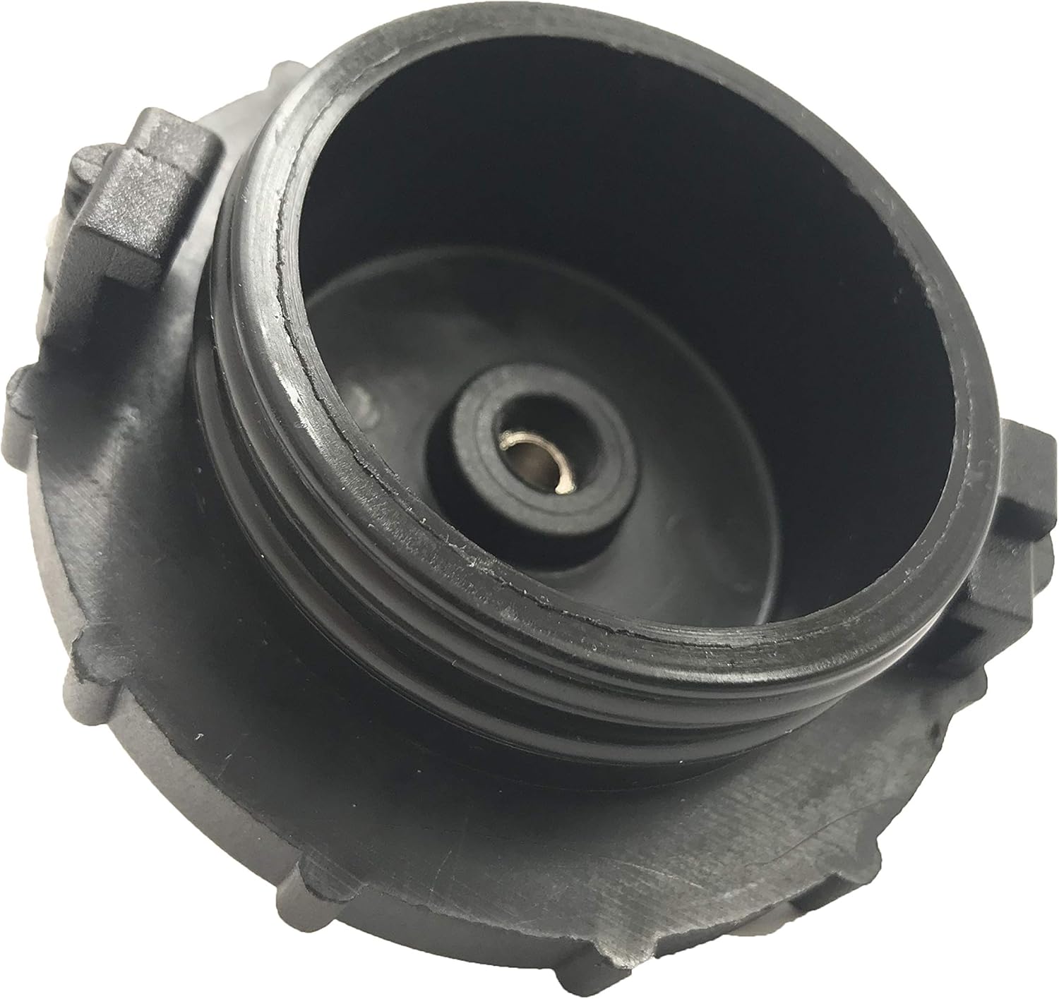

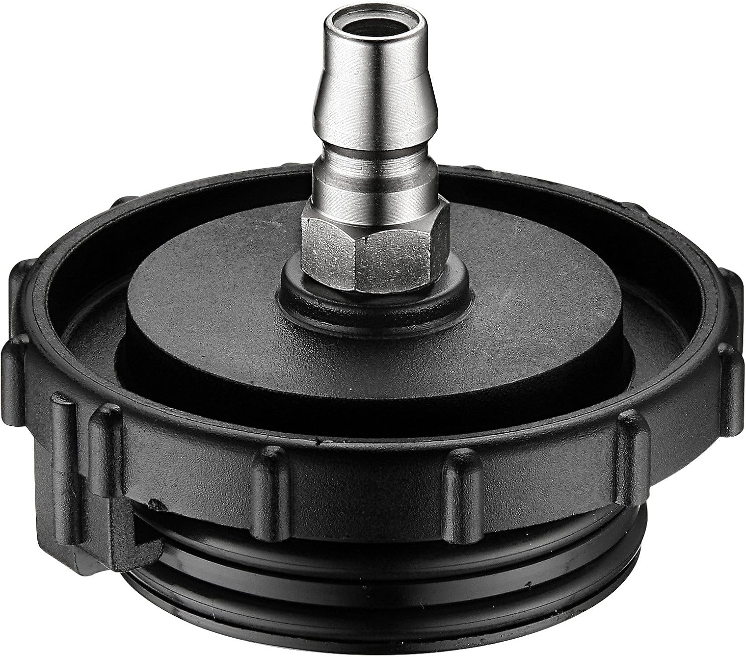

Has any one used the CTA Tools 7030 Master Cylinder Adapter - Compatible with Honda on their Motive brake bleeder?
https://www.amazon.com/CTA-Tools-7030-Cylinder-Adapter-Honda/dp/B01MYXAXS5/ref=sr_1_25?dchild=1&keywords=Motive+brake+bleeder&qid=1610146141&s=automotive&sr=1-25
$28.34
Ralf11
Feb 29, 2016
2,275
I use an old brake reservoir cap and drill a hole in it; put a male fitting for a hose, then clamp it
the adapter is $28, so I saved 25
